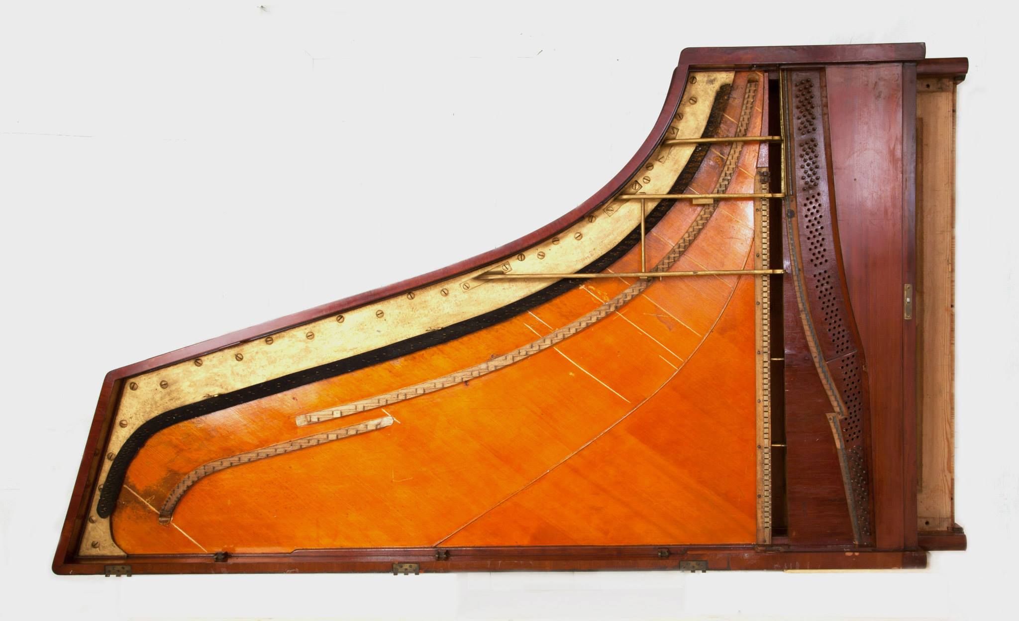

    Here's a Stein reproduction that is at the University of Nebraska. Dampers go to the top. The operation of the dampers is very similar to modern pianos except there are thin pieces of wood that slide between the strings instead of a damper wire. The keys lift the thin wood to lift the damper individually and there is a knee pedal for lifting all the dampers. It works quite well.

    I'll try again with the picture.

    I am mistaken on the original builder that was the source for the UNL fortepiano. It's a Walter copy. UNL hired Philip Belt to build the reproduction back in the late 1970s or early 1980s. Belt was quite a colorful character and came to Lincoln when the fortepiano was first delivered.

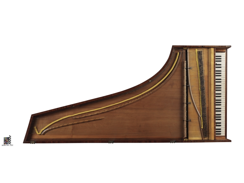

    A Chopin era Pleyel grand, showing clearly "missing dampers at the top." https://www.youtube.com/watch?v=_sBvZh_GI9A
    "A mind is not a vessel to be filled, but a fire to be kindled." Plutarch
  • 21.  RE: When did pianos start losing dampers?
    Posted 10-21-2015 15:58
    1836 Pleyel.
    "I am only interested in music that is better than it can be played." Schnabel
  • 22.  RE: When did pianos start losing dampers?
    Posted 10-21-2015 16:29
    1808 Broadwood.
