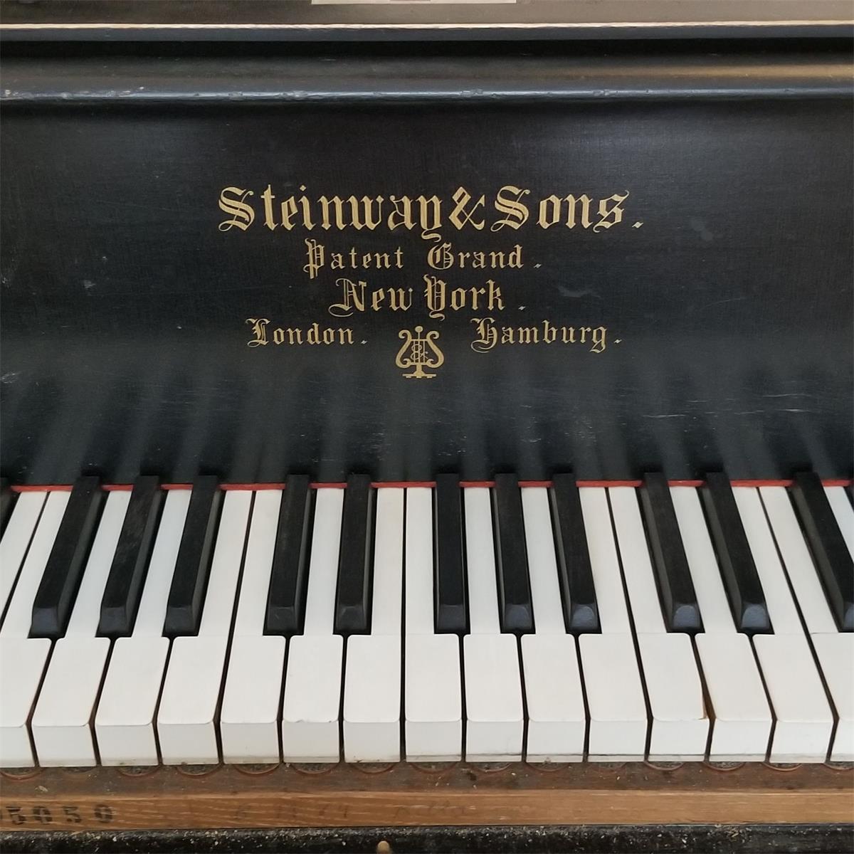

    Am I hearing you say that I could somehow create a stencil of this decal?  How to do that I am wondering!

    Take a very clear picture of the decal to a print shop and they should be able to make a stencil from it.
  • 13.  RE: Steinway decals
    Posted 09-08-2023 04:33
    I once replaced a soundboard on an 1888 Chickering Concert Grand.  There was a Chickering logo and serial number on the board.  I photographed it and had a Screen Printing Stencil made.   Printing it on the new board was a one off use and well worth the minimal investment.  I think the stencils can be cleaned and reused.  Could possibly be applied to Fallboards with bronze powdered ink.  Photo taken 33 years from the time it was installed attached.

    I've never actually done it but I've seen videos featuring a Cricut stencil cutting machine. The stencil material has a mild adhesive on it to stick to the surface, minimizing bleeding. This process is functionally identical to hand painting which is functionally identical to restoration of an original (and is not a decal).
