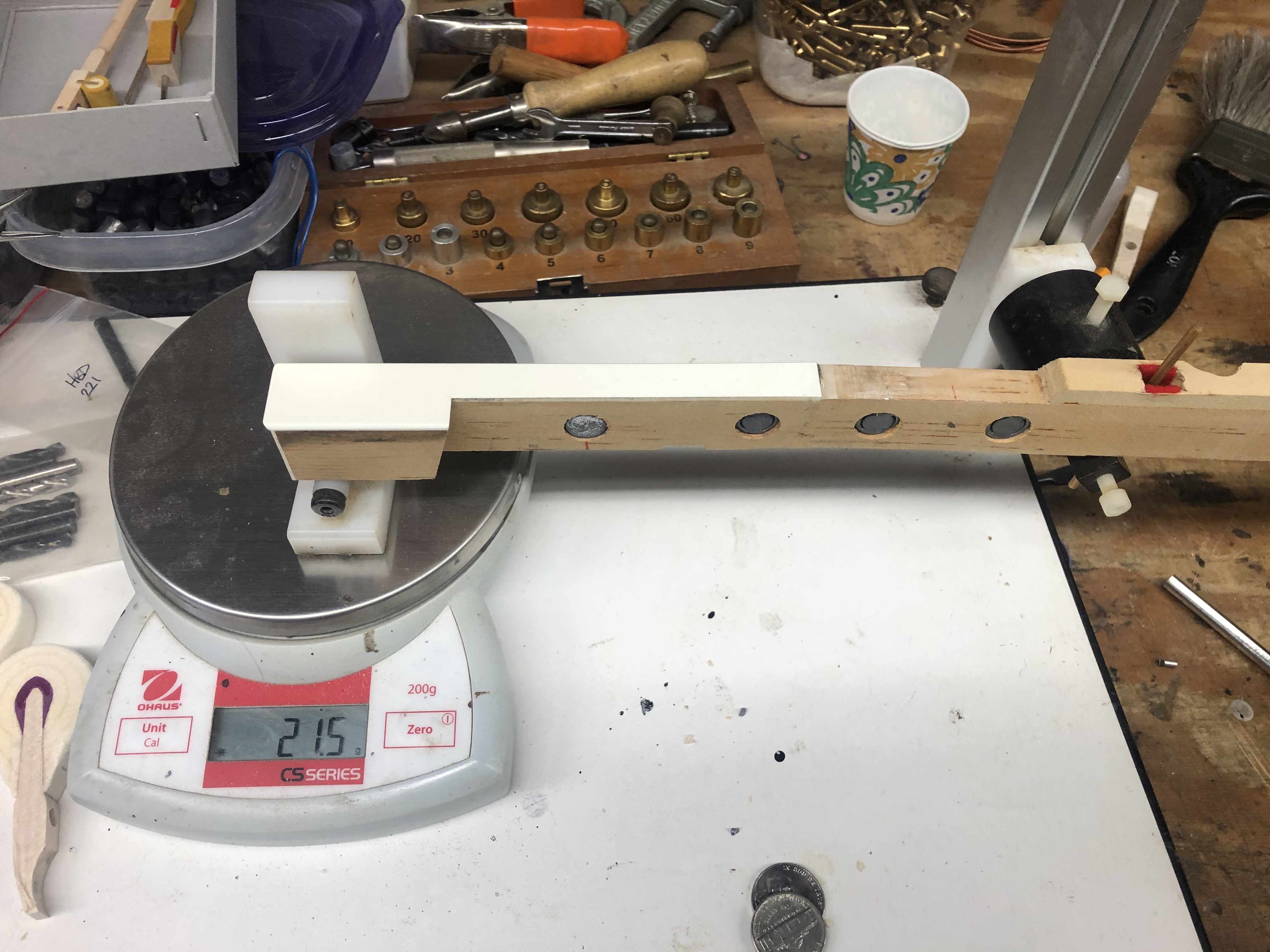

I agree that the lead pattern is an indication of whether you have a problem, but it's really the lead pattern as it relates to the balance weight. A piano with relatively few leads but with a very high balance weight likely has a problem. Similarly a piano with lots of leads but a very low balance weight may not have a problem. Typically I use the front weight (rather than the number of leads in the key) and a medium balance weight as a guide. For C4 that would be a front weight of 24 - 25 grams with a balance weight of 37-38 grams (balance weight being (UW+DW)/2) and from there create a smooth strike weight curve. Others may have a slightly different standard but that's mine and there is some leeway.

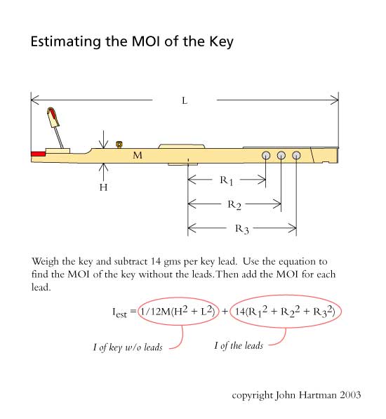

It should be noted that the greater the range of from A0 - C88 the greater the difference in MOI from bottom to top (your are correct that it's the MOI that we're referring to). A0 with more hammer mass will always have a higher MOI than C88. The goal is not to get get the MOI the same from top to bottom. That would require either uniform SW through the scale or a graduated AR, lower at the bottom and higher at the top. Not realistic or even desirable, necessarily.
A single lead being added to a key isn't necessarily a problem but it might be depending on your starting point. For example, if you have a FW of 25 grams (very ideal) and a balance weight of 45 grams (not very ideal) then to lower the balance weight to 38 grams you would have to add only one of your key leads in the center of the key to drop the BW by 7 grams, as you pointed out. But that would push the FW up to 32 grams which is, in my opinion, too high and indicates an MOI that is going to be too high through the scale.
As David Stanwood pointed out, the FW:BW relationship is a very good indicator of whether you have an MOI that is too high (or too low). For the pianist the concern is the resistance to acceleration, not the static weight, necessarily. You want some level of resistance to acceleration because the pianist must be able to feel the "throw" of the hammer. If they can't, then you have what we refer to as a "fly away" action. But if there's too much resistance to acceleration then the key is fighting you too much. That affects the pianist's ability to stay relaxed and forces a different kind technique, one that is more based on arm weight. That's not always good (though good pianists can utilize that technique) and can create problems with rapid passage work at the pianissimo level.
The key, and even the key leads, contributes relatively little to the MOI as compared to the Action Ratio:Hammer Mass relationship (the wippen contributes almost nothing which is why drilling holes in the wippen to reduce mass or static touchweight is a waste of time).
