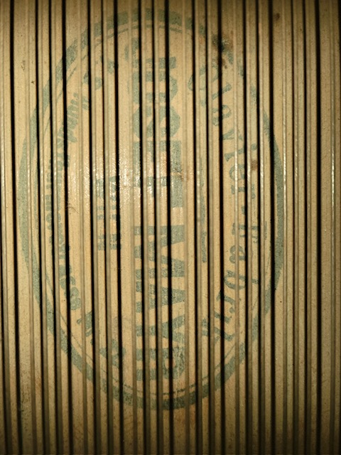

    I just got a call about tuning and checking out this grand.
    Anybody have some words of wisdom about what to watch for?

    The date is probably too early. Grossbach's Atlas indicates 1886-1900.
    This instrument really needs the services of someone interested in and knowledgeable of pianos of this era.
    These are factory made instruments, not rarities. They are not substitutes for modern grand pianos.
    The owner needs to know what they have and why they want it. They might do much better with a Yamaha or Kawai vertical for playing, study and practice.

    this is one more picture. I won't see this piano until after Burning Man,, first part of September. Thank you for the replies.
    The guy is German Woodworks. The piano is in his warehouse. I don't know the whole story. He would like it tuned,,,,,,
    For some reason, that didn't seem easy as it sounds,,, haha

    While I don't like to generalize, I will say that late 19th century Viennese action grands in fancy cases are similar to late 19th century English birdcage uprights in that they are most often low end technology in fancy decorative cases. Shipped to the US they often wind up in antique antique stores presented as rarities. The dealers are often looking for the cheapest possible "just tunings." Proceed with caution.
