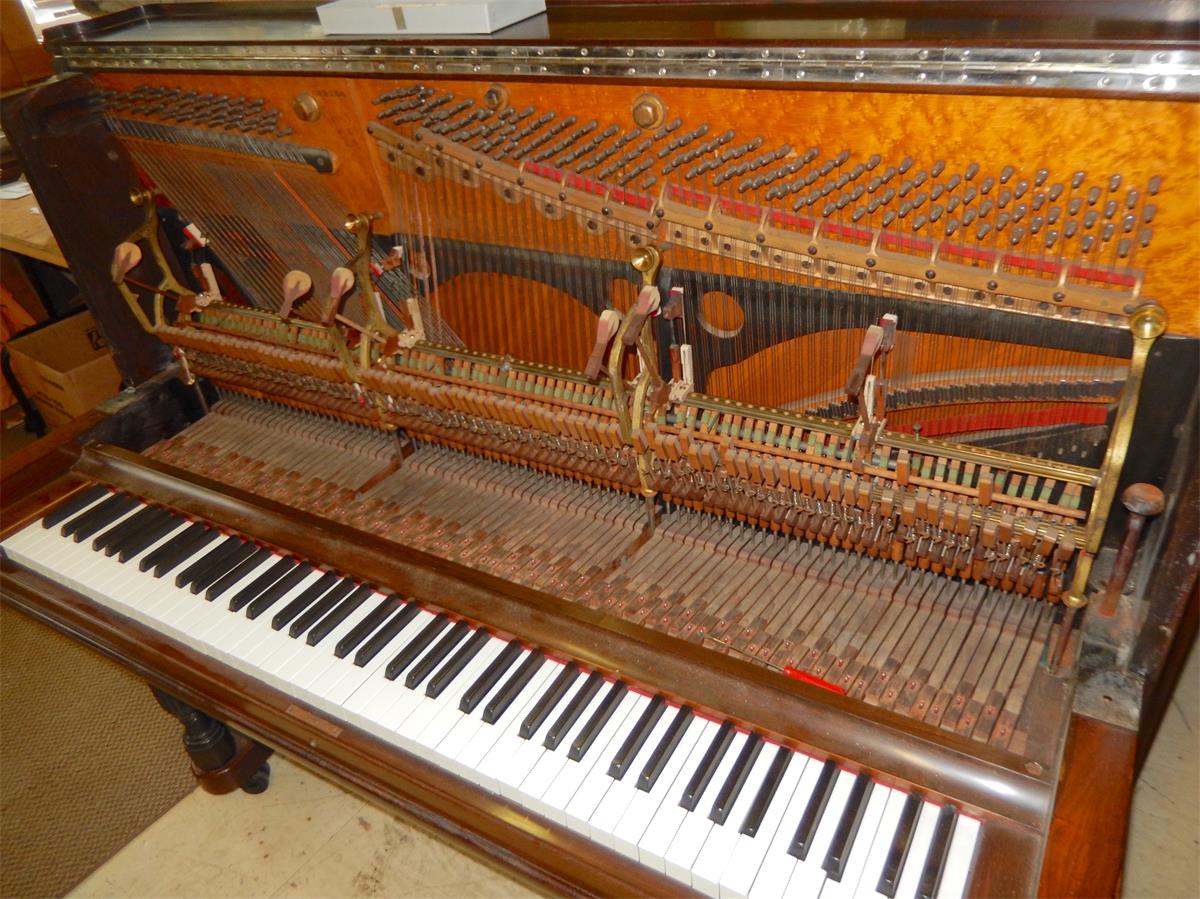

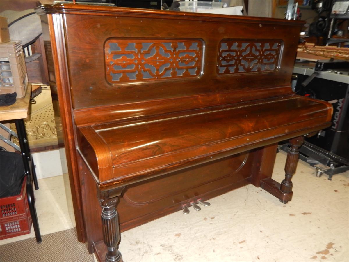

    I just picked up one of the most beautiful upright pianos I've ever seen today. It's a Steinway from 1877. I plan to rebuild and refinish starting later this year. Has anyone rebuilt one of these? What was different or particularly challenging about it?  I like to mull over my projects a while before starting. :)
    Thank you!

    The veneer work is stunning. You need to do some research on the pianos history. Do you have a model number and serial number to zero in on

    Hi Tim,
    This upright is almost modern in his design but has a few differences from the modern Steinway that was built up through the 1930s. Fortunately, it's not the extremely tall variety so you don't have the extra sticker action with the less friendly rocker adjustment. And also, you're fortunate it does not have the sostenuto system, which would add many hours of work and require having to deal with delicate damper levers with sostenuto hooks.
     You'll still have to make decisions about the damper levers, which are the most vulnerable part in the action for breakage - the weakness is at the butt plate screw hole - but also become wobbly due to the center pin slot becoming worn at the ends, and unable to avoid side to side wobble of the damper even with a tight butt plate screw.   Sometimes we find these damper levers riddled with weakness,  and other times pristine, though one should also suspect age will cause breakage, and with this set of parts, be prepared to do careful repairs rather than rely on replacement.
    The primary difference with the action is it yours probably has the wooden damper lift on the whippen rather than a spoon, and an adjustment screw on the damper lever corresponding to the wooden spoon location. If you retain the original wippens, you'll want to carefully go through and reinforce any glue joints in the whip assemblies while replacing jack springs.
    If you choose the parts replacement route, you'll need to replace both tamper lever and the wippen because of the design off match of the damper lever with an adjustment screw and the whippen with the wood "spoon" - replacing all dampers, levers and wippens with Tokiwa matches might be successful (actually, I'm not certain if it's Tokiwa, or someone else that makes these parts - I think  Randy Morton has told me in the past it was Imadegawa - the important thing is that it is a currently available supply through importer Randy Morton with Pacific Piano supply company and the other supply companies who buy these parts from Randy.).
    The double flange used for the hammer, butt and damper lever will take some getting used to if you are not familiar with it, but you will develop a skill set or routine that works for parts, removal and reinstallation, both Wholesale and the individual.
    If you haven't already, you'll develop an appreciation for removing the hammer rest rail - like Yamaha rest rails, you can unscrew the opposite hanger off and loosen or remove any interfering part, it's pretty straightforward and it's very helpful and working on the action.
    And by 1877 Steinway was using dowel capstans instead of rockers.
    Just for fun, your piano should have one or two points where the soundboard can be compressed via bolts in plates flanges. The most likely one is in the high treble and seen from the back of the piano.  This is the residual patent resonator system, which was applied comprehensively with the double iron uprights, which were discontinued by 1866.

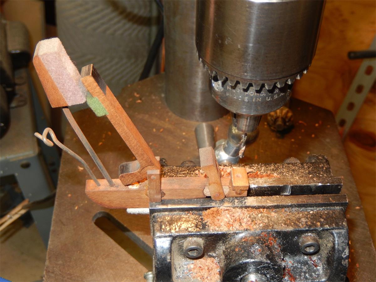

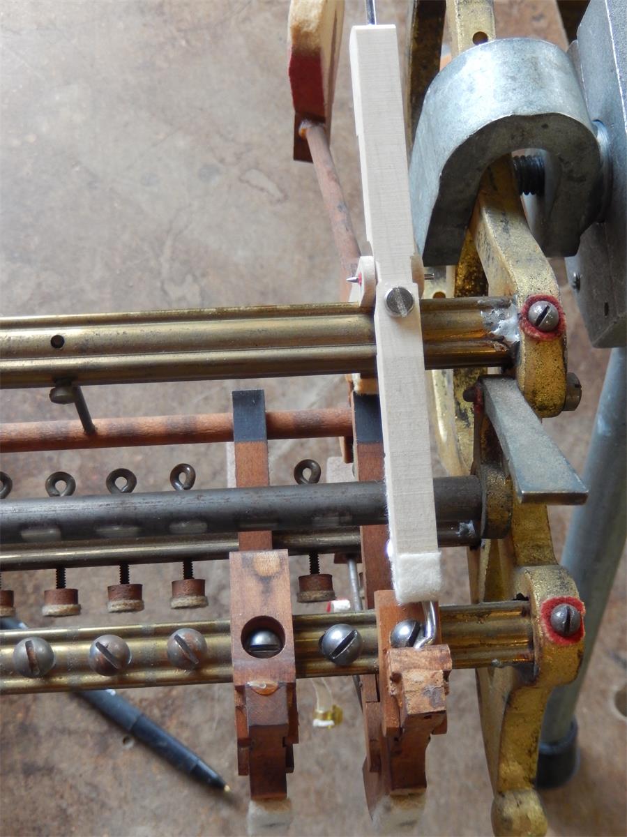

    A little addendum to Bill's excellent overview:
    The challenge of the double flange is partly due to it being at right angles to the string plane. As a result, if you loosen the screw and twist it slightly laterally, hoping to align the hammer to the string, you are actually changing the hammer's travel to the string. Any lateral adjustment should keep the flange perpendicular to the line of the action rail, shifting the whole flange within the play between screw and screw hole.
    Papering under the flange can be done for alignment purposes (it won't affect travel). However any changes done to accommodate the hammer to string alignment will also affect damper to string alignment.
    It's challenging to get these right. I have never replaced parts in one, but have had the dubious pleasure of trying to clean up the mess of various others who didn't do a great job. I have puzzled over exactly how they might have done it in the factory. I suspect dampers were roughed in before shanks and hammers were glued in place, but that is just a guess. If someone has a different guess, I'd like to see it.

    Hi Fred,
    You're spot on to bring up the double flange action challenge.
    My practice is to travel the just-installed hammer butts with a dummy hammer shank (shimmed tight w paper) and a square, then to install the damper levers and dampers.  Not until this is done do I install the hammers and shanks - in the piano, permitting hammer/string alignment during installation.
    It's a variation of the Spurlock vertical piano action rebuilding procedure, especially helpful for squaring up the double flanges from the first.

    Some great things I see are the plate design and all of the stencils. The plate was cast at the Steinway foundry -another interesting thing. Exposed p[in block looks great as do the coils, bridges, soundboard. Take tons of pictures of everything before and after you do work. Amazing that it has had only one owner. If you go to the antique piano shop website you may be able to find a catalog with more information

    The veneer looks like walnut burl. And the finish looks original, it is probably French Polish (shellac). Please don't strip that off and spray or brush the piano with some modern finish.
    A 150 year old finish has its unique patina. Removing that finish will devalue the piano both econimically and historically, not to mention visually.

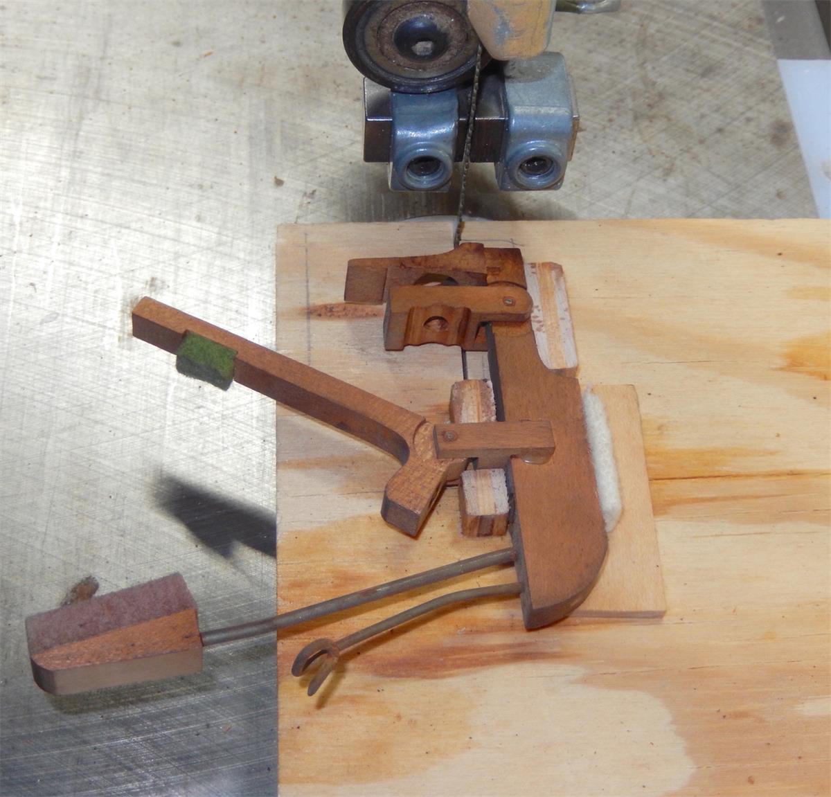

    A photo of what Bill Shull was talking about - the damper arms with their butt plates, the wooden "spoons" and the adjustment screws for damper lift. This Steinway piano is from the 1880s.

    Mine is an 1879 Model E, identified on p.22 of Kehl&Kirkland's "Official Guide to Steinway Pianos", SN 42184. The size (49-1/4") is a little confusing because it would tend to be the 48" instead of the 46", the former being '84-86 and the latter '78-84. I did replace the original casters with 2" dia. double-wheelers.
    This is a "bucket list" piano for me, and my last work on it was making sure that the front-to-back wire bends on the new damper levers picked up the damper spoons at the same time as neighboring originals.
    Ain't she a beauty!?! (Somebody's grandma had a beautiful refinishing done a couple of years back.)
