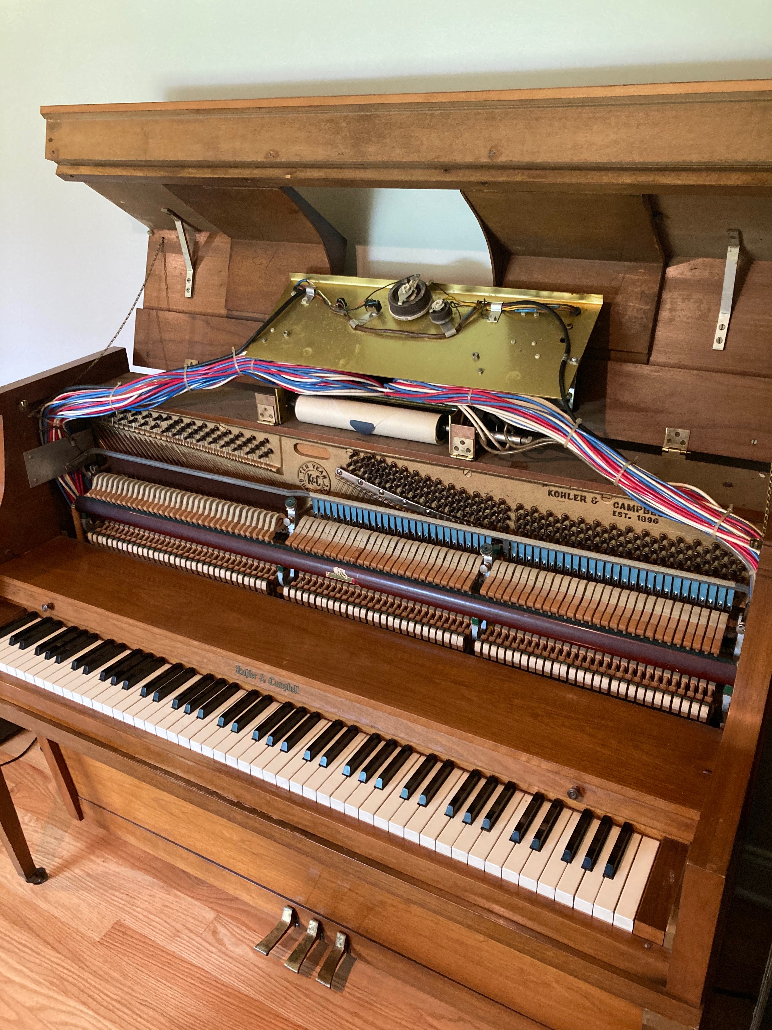

    Yesterday I serviced a K&C console with a Lemac Player system installed. Not realizing that the brackets were actually hinges, I spent over an hour removing and replacing the player only to realize that it would have just tilted up. See the attached pictures.
    I didn't disconnect any of the wires, just moved them out of the way. However, when I reinstalled the thing, it's only playing the rolls in reverse! I have no idea what I did or how to fix it. I've learned my lesson to pay better attention next time - but in the mean time, help!

    Just wanted to give an update here. I saw the player piano in question this week. As it turns out, the rewind button was functioning just fine but the block that holds the switch got bumped about 1mm. It was held in with a single screw, so rotating it back into position was easy enough. That allowed the switch to disconnect and turn off the rewind feature.
