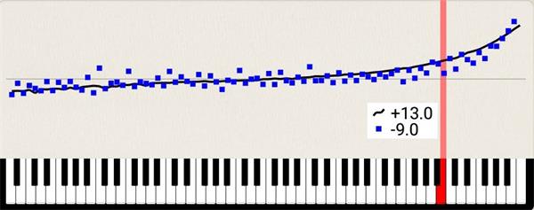

    Very cool. Looks a lot like Piano Meter which was developed by our own Anthony Willey RPT that strangely gets no love on this forum. For half the cost of this fine German program Mr. Willey an American RPT provides a program which is available for Android as well as IOS and measures the piano in the same manner and time frame described above. Best of all the program leaves a pretty blue dot on the tuning curve for each note it hears allowing the tuner to set the ETD aside, tune aurally and then get an immediate visual report of how well they matched the theoretical tuning curve. Nothing against pianoscope but why does everyone in this industry default to trusting anyone with a Teutonic accent over someone with a Midwestern one?

    Yes - pianometer is good although I use the Vogel CTS5 in battle.
    What the graph is good for in particular is showing what an instrument is like before I tune it
    and what it's like afterwards
    and this rather shows how flawed conventional tuning wisdom can be as that instrument, or a Steinway D
    Nice International Piano Competition 2022 - Unequal Temperament - (Piano Tuner's recording)
    or a Steinway S https://youtu.be/Pm2ZvjLVF9M?t=139
    can sound better afterwards than before.
    What appears interesting in the German software however (pity Android isn't available) is the ability to choose different and defined harmonic matching. That would be very interesting with which to experiment.
