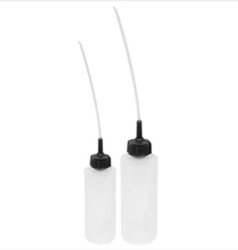

An alcohol-water solution can be used to soak the bushings. They will need to dry at least overnight, probably best to have it in your shop, maybe a hairdryer to finish the drying process.
Before you do this remove several of the "worst" action assemblies. I.e., the hammer flange, wippen flange, and Jack flange should all be checked for gram resistance. The bushing felt may have a red waxy substance that is causing friction. Repinning may be advisable.
If there is no waxy grunge the alcohol-water, followed by ProTek CPL may be all you need. Tighten all flange screws.
