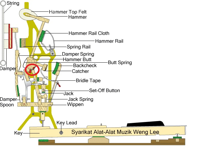

    I see.  I guess I will try correcting the root problem rather than changing other parts in the regulation.
    So I have the correct terms identified and I think the problem figured out.  The hammer butt leathers are worn creating a little too much friction.  And the hammer butt springs are worn out and too weak.

    Finished working on the 1961 Baldwin Howard spinet.  This lil free thing really has the tone once restored.  It took me 5 months since I got it in July since I had to learn as I went.
    I did absolutely everything I could.  I gave up on getting the backchecks working and just removed the hammer butt spring rail.  I have the option of hiring a pro tech to get the backchecks working but I like it how it is.  This is a list of everything I did summarized by the bot:
    Piano Restoration Summary
    Tuning & Voicing:
    • Tuned the piano to pitch.
    • Voiced for optimal tonal balance.
    Action Regulation:
    • Keys: Adjusted height, dip, aftertouch (approx. 0.050"-0.055"), square, and spacing.
    • Sanded keys to prevent rubbing and ensure smooth playability.
    • Adjusted the let-off to 1/8".
    Repairs & Maintenance:
    • Replaced two broken strings and reseated one misaligned string.
    • Cleaned the entire piano for optimal appearance and performance.
    • Lubricated the damper pedal for smooth operation.
    Modifications:
    • Disabled the soft pedal, leaving it in place for visual appeal.
    • Removed the hammer butt spring rail, disabling the backcheck assembly. This modification lightened the action, reduced mechanical complexity, and minimized future maintenance needs.
    Clint Jones
    Santa Fe NM
    (858) 232-4965
  • 27.  RE: Beginning tech questions
    Posted 12-18-2024 17:37
    Clint
    Please explain why you disengaged the soft pedal. Disengaging it has nothing to do with the playing ability of the piano, but it can be helpful to see which hammer flanges are on the tight side, not to mention that it can be used to reduce the sound of the piano.
    Removing the hammer return spring rail is not a good idea. Those springs are needed to return the hammer to rest position, enabling faster repetition.
    What did you do to "disabling the backcheck assembly". The backcheck is not an "assembly", There is one backcheck for each key, which are needed to help with repetition.
    This is the first time in my 50 years of working on pianos where someone took out the hammer return spring rail or disassembled the backcheck. Perhaps you need to reconsider.

    Hey Clint,
    There's a tool the suppliers sell specifically for adjusting backchecks in a spinet. Getting it will probably make your attempts of regulating the backchecks a lot easier.
    As others have said, I strongly recommend that you don't remove the hammer spring rail. As long as your piano has bridle straps, it might still function without the hammer spring rail, but you're likely to run into problems with hammers not returning once the weather changes and the humidity goes up. There's a reason that piece was designed into that piano, and removing it is a modification that will eventually come back to bite you.
    Every part in the piano is there for a reason, and generally we don't recommend making modifications unless you know exactly what you're doing and how it will affect everything else in the long run. When I was learning piano work, someone taught me this acronym: KWYADAWYADI - Know What You Are Doing And Why You Are Doing It. Keeping that in mind has served me well over the years.
     You’re on a good path, and I’d like to encourage you to keep learning and moving forward. A good next step would probably be picking up the book “Piano Parts and Their Functions.” PTG sells it for the cheapest price I’ve seen, and it’s definitely worth a read.
  • 35.  RE: Beginning tech questions
    Posted 12-19-2024 16:19
    Hi Patrick, I tried that and wasn't able to get the hammer to drop back to the back check.  That's why I have a feeling part of the problem is also the hammer butt leathers, making it a really big job.
    Hi Benjamin, I'll get that book so I can learn about all the parts.  Like I said, I originally planned to do everything correctly but this project was tormenting me so I bypassed it and ended up liking the results.  I'm pretty sure I understand all the effects to the mod.  I can always attempt the project again or hire a pro tech to do it.
    Wim, you're no longer welcome on my thread.  Nowhere did I proclaim that I was a legitimate piano tech and suggest that you all should be doing mods like this in your professional work.  I clearly said the whole time that I'm a beginning amateur tech working on a free piano.  It is mine and I can do what I want with it.  You don't have the right to hold me to your standard or forbid me to be on here with it.
