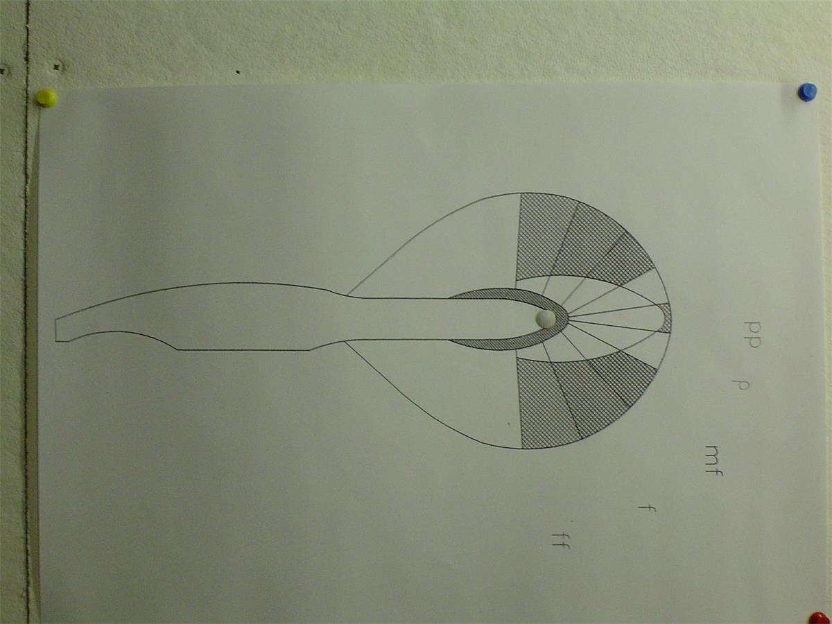

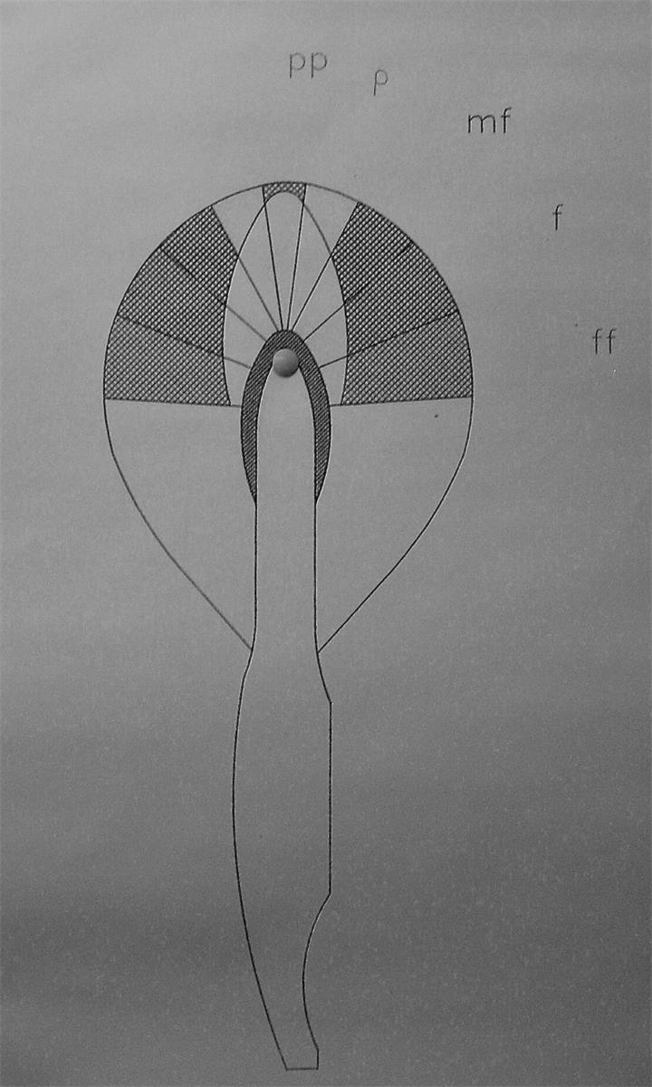

    Here are drawings from one of the voicing room walls taken when I worked there in 2007. I learned a great deal about shaping during my time there.
    David

    David -  thanks so much
    Unfortunately the link goes to
    "Library Entry was not found. The document you've requested is no longer available. It may have been moved or deleted. Please contact the administrator for more information."
    Email address is antespam@gmail.com and it would be really appreciated - thanks so much
    With regard to Steinway hammers there is a difference between New York and Hamburg. NY hammers are soft and have to be hardened up. Hamburg hammers are hard and have to be softened up. This has an influence on reshaping and as pointed out, taking the shoulders off flattening of NY hammers will remove some of the relevant doping whereas removing shoulders on Hamburg hammers is fine.
