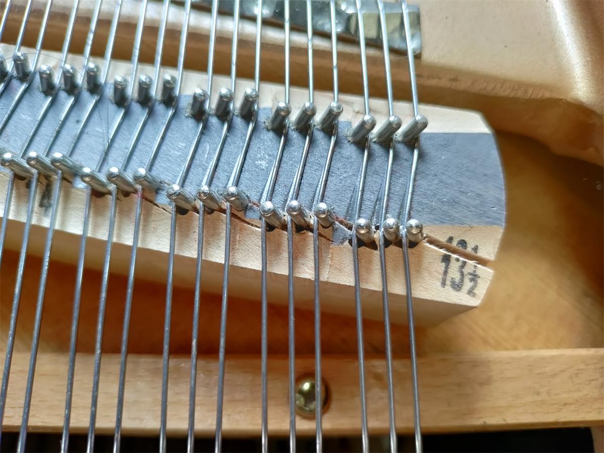

    It seems like a really bad idea to have pins lined up along the woodgrain.

    Looks like a case of excessive side bearing (s/b). A new cap to correct the s/b and eliminate the crack is in order. Warranty?
    In that area, it's impossible not to have the pin line along the grain line. I think it was the older Knabes that had the cap's grain parallel to the wire. That split even more!
  • 5.  RE: Boston Bridge Splitting
    Posted 08-27-2022 12:54
    I have been thinking about these severely split caps recently, particularly after recapping the high treble on a Steinway upright. When the split is as severe as in your photo, it seems that the bridge root may deserve a lot more credit than the cap. In vertically laminated bridge roots, one particular layer of laminations seems to get drilled, weakened right along the speaking side of the highest several unisons.  The laminations are often as thin as the diameter of bridge pins, and that one layer's glue line severely eroded. Then adding the pressure of tight fitting pins, and the laminations can open like butterfly wings.
    Can you see the side of the bridge root? I'll bet the root is split or the laminations are separating right underneath the split cap.
    I wonder if staggering the laminations' orientation or putting a solid piece for the bridge root at the high end would help prevent this condition?

    Actually in the photo, the grain isn't parallel with the pins. And Jon alluded to severe sidebearing. But neither of these issues is the cause of what you see. Its simply that they used wood with a too low janka hardness. Even hard rock maple (which i believe is too low in janka hardness) doesn't tear like the wood in the photo did.

    The wood might be a weak point but if you notice the old string marks, You'll notice excessive side bearing. Had there been normal side bearing, the wood might not have let go. The side bearing is OK now in its shifted state.  I would remove the pins, epoxy and clamp and install plugs made from pin block scraps. Being careful to relocated the pins to their new position. That is, if it's not covered under warranty.

    If out of warranty the simplest fix would be to simply epoxy things together in their current configuration with no clamping (remove tension of course). Create a dam and fill it with thin epoxy with hypodermic needle. Done...not going anywhere.  KISS
  • 10.  RE: Boston Bridge Splitting
    Posted 08-30-2022 01:19
    I agree to keep it simple.
    1.  Remove the strings from the affected pins. Detach from the hitches only and move them to the side.
    2. Use a two part epoxy like West system with a medium density filleting blend. Use the faster catalyst. Mix it so it's just slightly runny, a bit thicker than honey so it doesn't run all over the place. It should be thin enough to inject with a glue injector but thick enough that it won't run freely.
    3. Using a glue injector with a fine tip inject the glue directly into the bridge pin holes. Remove them if necessary while you inject to capacity and replace the pins in the proper position.
    4. Use a couple of small C clamps to pull the cap back together but don't feel that you need to squeeze it together as you would using Titebond. Epoxy works better when there is some thickness to it. If the glue line is 1/32" or so wide (or even slightly wider) that's ok.
    5. Clamping should produce some squeeze out. Make sure it does.
    6. Using some dental tools and a small flat blade screwdriver, clean up the squeeze out. Be careful to clean all the excess from the top of the cap and from around the base of the pins and try and smooth the notch area. Use a magnifying glass if necessary.
    7. If you've made the epoxy thick enough it should hold its shape and not migrate or run but hang around long enough for it to start to cure and check it frequently adding small amounts of epoxy with the small screwdriver blade if needed.

    1. Pianos with little cracks around the pins that cause false beats. I have used a little super glue. Is this best or is epoxy a better fix.
    2. Old Baldwin upright with bridge cap separation. The piano isn't worth much. But it is a friend's who is attached to it. From a purely construction aspect. I would think a little tite bond and a couple of brads from a nail gun would do the trick. Is there a proper fix? Epoxy?

    CA for the bridge pins but you should have dental tools to clean any migrating glue off the speaking length and any bead that may form between the notch and wire.
    For the upright cap repair, screws are better than brads.

    Because of the proximity of the piano it was probably a couple of days before I got back there to put the strings back on and pull up the pitch. Epoxy does take a bit of time to cure and you want it fully cured and this is two-part epoxy which is slow setting so I would say at least 24 - 48 hours would be best.

    Agree completely with David, and what an excellent description! This is exactly how I would do it. I've done several but David clearly has it down to a "T". I have used the filler for several repairs but getting the thickness just as he describes will definitely help me in future repairs.

    From what I could see the grain runs almost but not quite parallel to the pins. On many other pianos I have observed that the grain often runs more diagonally.

    I made a similar such a repair on a Bos 225 several years ago and it held up just fine. I used west system epoxy with some filleting blend. I took the strings off in the section pulled the loose pins out and pulled the bridge back together with some clamps rather gently and reinserted the bridge pins before things were cured after cleaning up the epoxy.  Some fine dental tools were helpful.  It's now probably 15 years later and it's holding just fine and you really can't even see the repair.  Of course if this is under warranty you might want to approach it with that in mind.
    It's not that difficult a repair if you're patient and careful. As to why it happened it's hard to know but it might simply be that the bridge cap material wasn't properly dried. The grain angle is likely not the problem.

    If it is out of warranty you could try removing the strings in that area, clamping and gluing the crack (I personally use Titebond) and after it is dry, and if you have adequate access, drill the bridge from the side and glue in a dowell or two (a hammer shank might work), then trim it flush.
    This has worked for me.
    I have also installed a machine bolt through the bridge, but only on spinets where it won't show.
