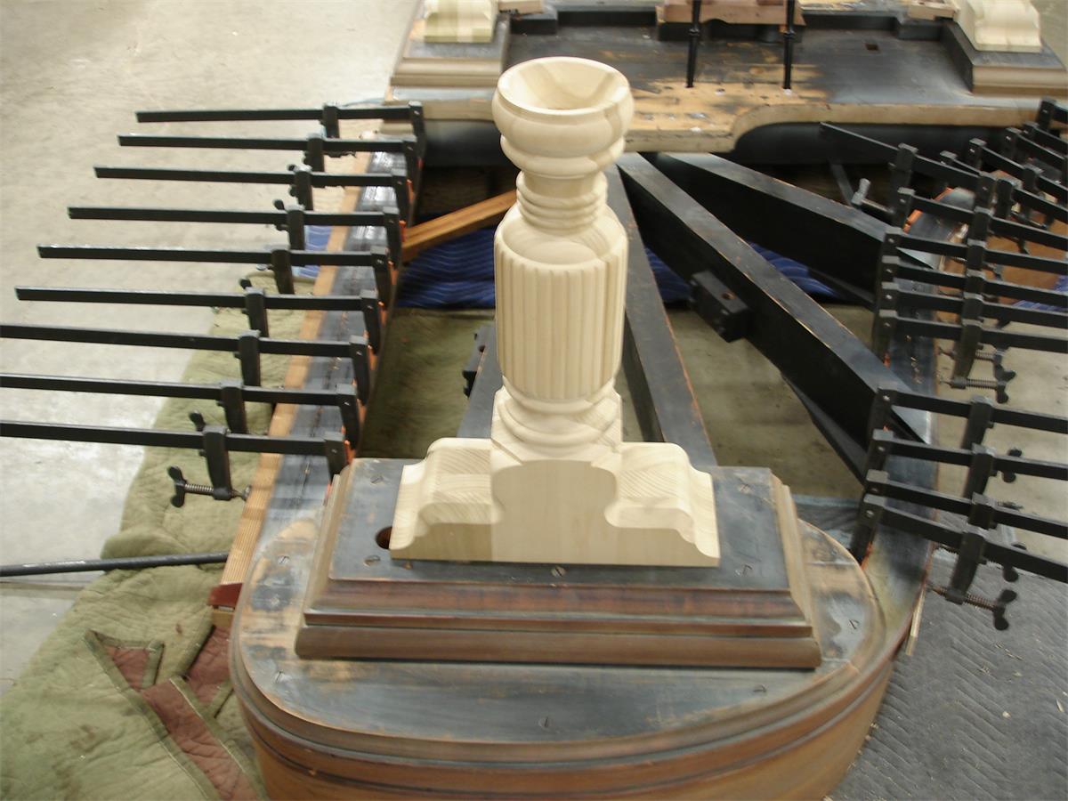

    I'm working on a 22 year old Boston GP-193 grand. I am told it was in an older (now demolished) building with steam heat for about a decade before I started. The inner and outer rims are separating, up to 1/16" gap in places. The veneer has lifted from the front corner where it's flat on the treble side to where the bent side begins (included just for information). I am going to recap the bridges and restring, so the piano can be flipped over without the plate. Attempting to clamp the rim completely closed will probably not do much good. The plan is to fill the voids with epoxy and just as much clamping pressure as it will accept. I typically will use System Three Clear Coat for this as it has a high tensile, flexural modulus and low elongation properties when cured, and because it is low viscosity to flow into the voids. Looking for feedback from anyone who has already done something similar. TIA

    I have pulled numerous separating rims back together. If your widest gap is (only) 1/16" you can probably pull in back together with beefy bar clamps, spaced tightly around the perimeter of the rim. See attached photo. I had great success with cold hide glue for this procedure. Work a ton of it down into the fissure. Drill injection holes into the inner rim to hydraulically pump the glue in if you have to, filling them with plugs or screws later. Indeed, if I felt more fortification was required, I ran #20 wood screws through the inner rim into the outer rim all the way around. A right-angle drill was used to create all the necessary through and threading holes. In any event, leave it clamped up for two days before even thinking about un-clamping. Best of luck, my fine friend.

    I have used this technique on Steinways as well as Asian two-separate-rim pianos. I have performed it on Mason & Hamlin pianos as well, another two-separate-rim, American piano. The results are the same.
    I go back and look at these pianos years later. There is no separation.
