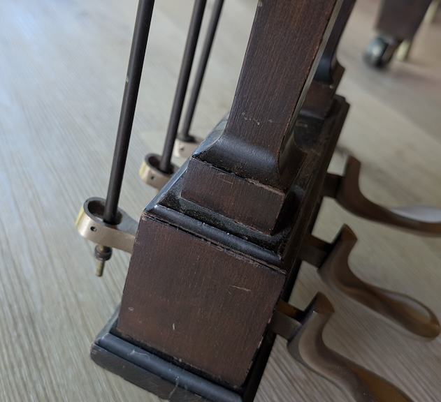

Pedal rod on the left probably belongs on the middle and is upside down. Looks like the pedal rod cups have holes in them so maybe a pin holds the pedal rods. You will need to check it out in person. I think the middle pedal lifts the bass end dampers which means the damper lift rail is split and will need aa pedal rod like the left rod with the pin going into a hole under the tray . Brambach was a low end affordable piano
Sent: 12-07-2024 19:24
From: Wim Blees
Subject: Brambach grand pedals
It looks like the rods are upside down. Or there needs to be a large washer of some sorts between the rod and the pedal.
Sent: 12/7/2024 7:20:00 PM
From: Steven Rosenthal
A customer sent me this picture of this small Brambach grand that arrived from a relocation missing some pins that secure the rods to the pedals. I'm unfamiliar with this set up. Are there parts missing?
Thanks in advance.
