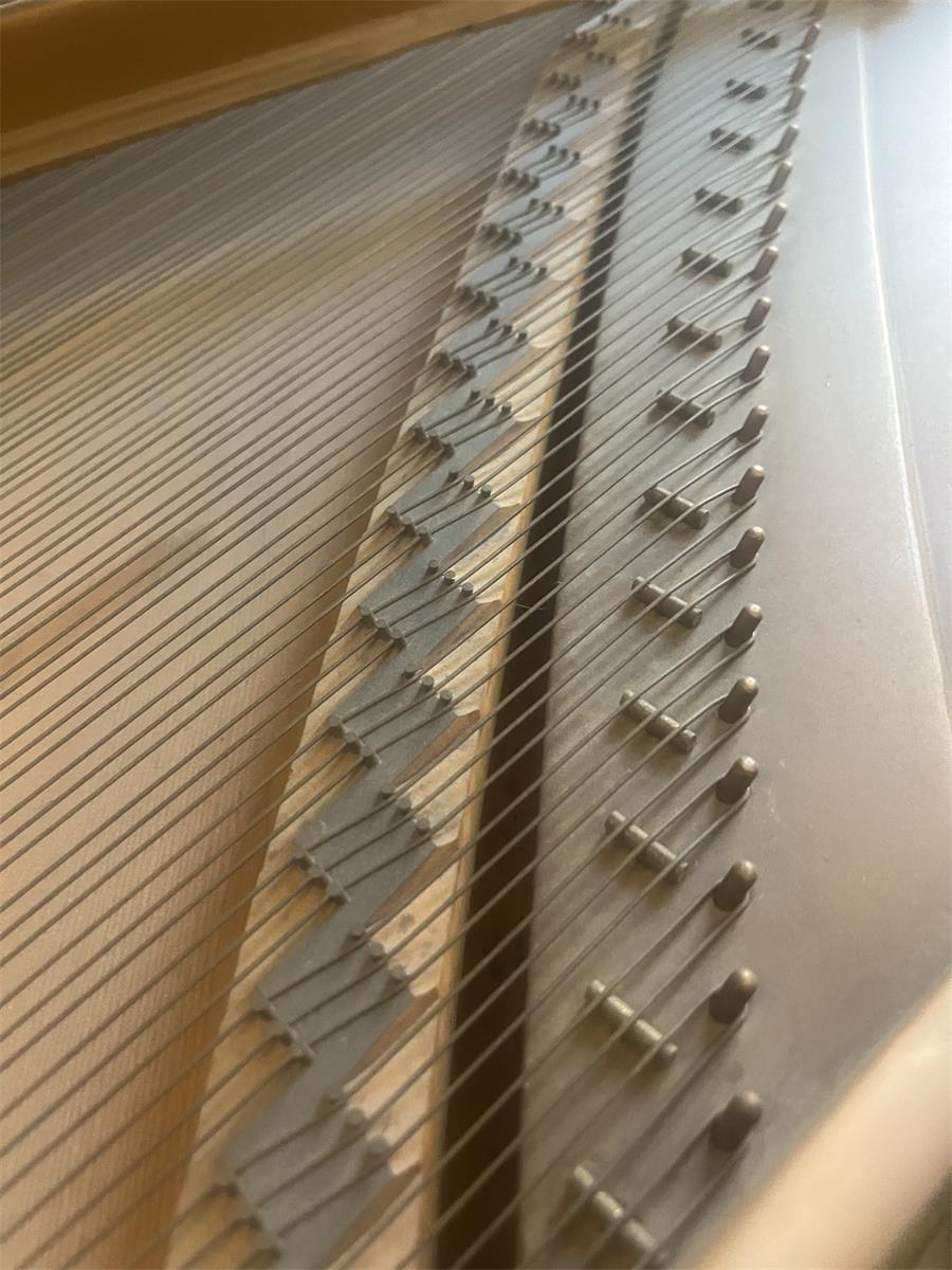

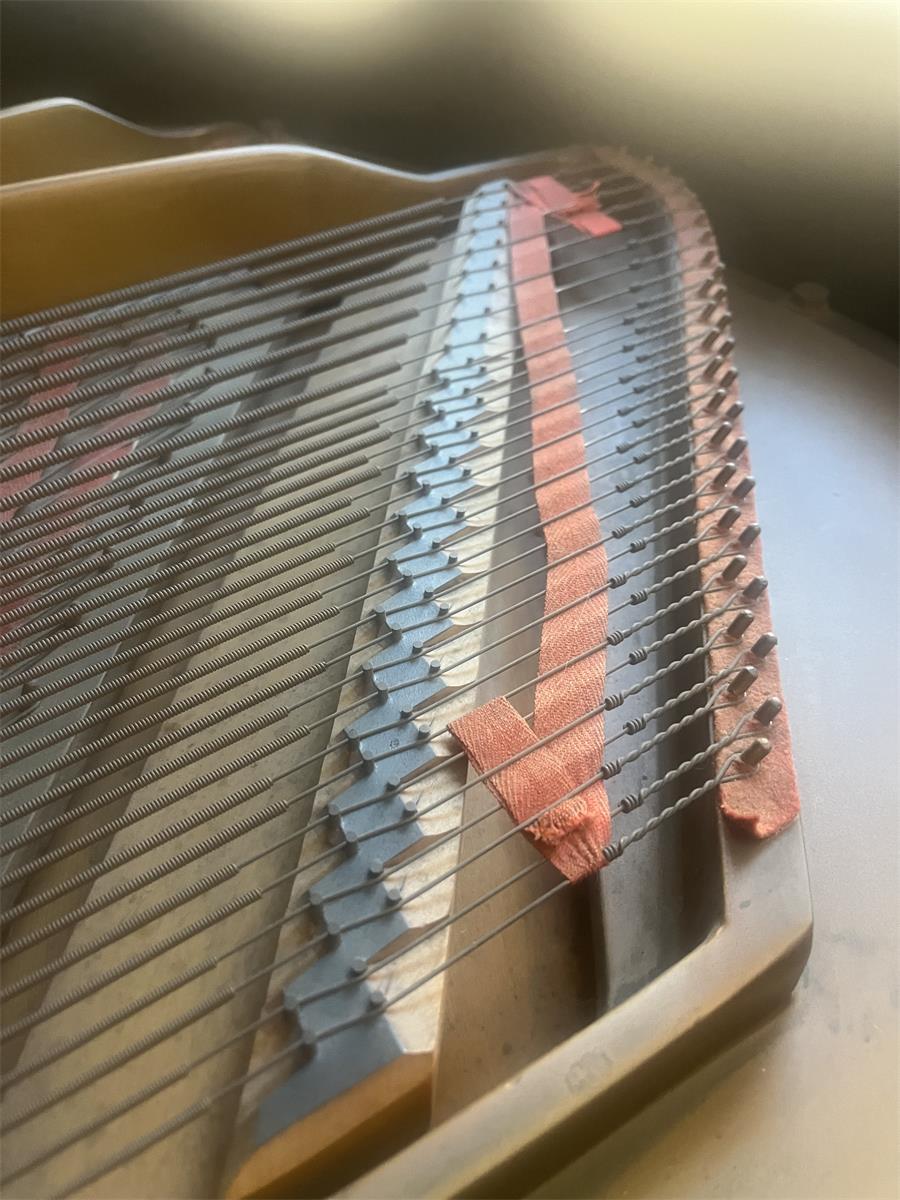

    Hi, My name is Brendon and I'm new to the community.  I am not a tuner or technician, however, I'm very interested in taking the steps to become one.  Recently, I was gifted a Baldwin Baby Grand that I believe was made in 1936.  It was pointed out to me that there are some small cracks/splits in both bridges and a potential larger crack forming on the bass bridge.  From what I have gathered this will prevent me from possible getting a stable tuning and the repair will likely be very expensive.  Is there a possibility that given the size of the cracks that I'd be ok to have it tuned and hold or is this going to require an expensive repair?

    The very small cracks on those bridges are of no consequence. No need to repair them. And you should have no problems tuning the piano.

    Thank you Wim.  I was quite discouraged as I thought this was going to be a very costly repair.  I appreciate your time in responding to this!

    The cracks you have on the Baldwin are not a problem.You can learn from someone how to repair them. One great thing about having a piano is you can practice doing repairs on as well as tuning and regulation. Good Luck
