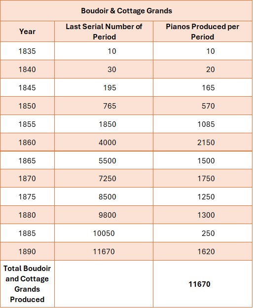

Underdampers would indicate an instrument possibly in the 1850s. Not later.
If the decal on the fallboard is paper in a wooden rectangle it is before mid 1850s. If it's squirly script it will be late 1850s to 1870s and if a typeface lettering, later.
If the wrestplank isn't iron with threaded pins, then it's 1850s and before.
