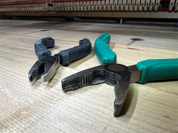

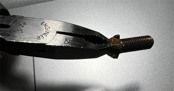

    You've gotten a lot of good responses. Here are a few items:
    • If there's any portion of the stud sticking up at all, I've found the simplest, easiest, least intrusive approach is screw removing pliers.
      agraffe
    • If that isn't an option, I use a center punch to mark the center of the stud and use the lefthand spiral drill bit. I work very slowly and hope that the agraffe just backs out (which it usually does) and I'm ready to move forward. If it doesn't then I'm already drilling my hole for deeper work.

    Thank you, everyone for your help with this. I returned today and extracted easily with reverse 1/8" drill bit and a little "guide" I bought. (Photos below.) The piano could use a lot more TLC, but it shaped up nicely (80 c pitch raise).
    The client is trying to downsize after his wife's passing three years ago. The piano was hers, he doesn't play and he plans to sell the piano. After tuning, I played my new favorite Sibelius piece. He broke down sobbing, and wasn't able to speak for a minute or two after I finished. Finally he got out the words, "I wish my wife could have heard that, she would have loved it." He asked me if I could play it again and record it for him (I included below, just a cell recording).
    For all the frustration of this piano, it was also very rewarding.
