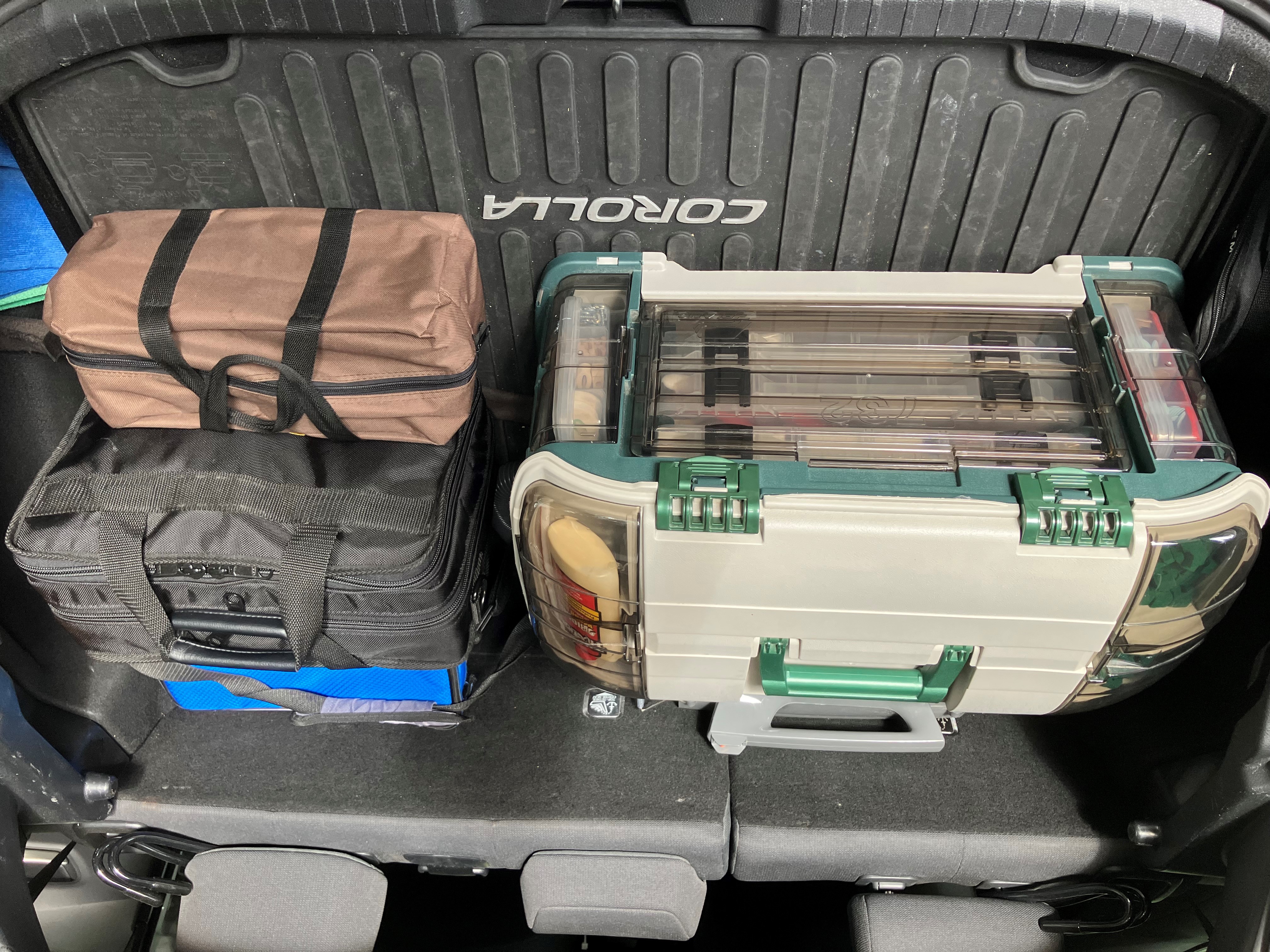

    Posted 08-26-2025 15:35
    Below is a picture of my current car set-up. I drive a Toyota Corella hatchback, which has a smaller trunk space than my previous vehicle but still plenty big enough to transport everything I need on a daily basis. I can even put the seats down to transport an action and still carry all these tools.
    My main tool case is the black one. This holds all my regularly used tools (tuning, regulation, voicing, screwdrivers, and some pliers). This case covers about 90% of the jobs I do and is usually the only one I take into homes.
    I also have my stringing kit (the brown one) from Supply88. This only comes in with me when I need it.
    The blue cooler is my chemicals kit. This includes things like my polishes, ProTek, CA glue, wood glue, and any other adhesives or lubricants I may need. Being insulated helps to preserve the chemicals inside from the summer heat.
    The big tackle box is my repair kit. It holds all the tools and related supplies to do all the repairs I do out in the field. Every internal container is sorted by job. I built this case up over the course of three years. Every time I had a repair job, I would make sure to buy extras of the supplies for that job to save for next time. It was a good way to build up a parts supply without breaking the bank.
    Behind the repair kit is a portable vacuum and other cleaning supplies.
    However you organize your car, customize it for your specific business. Don't carry things for jobs you don't do, and make sure to carry tools and supplies for the jobs you do. Organizing things into specific cases goes a long way. The longer you work on pianos, the more you'll find exactly what you like and how you like it.
