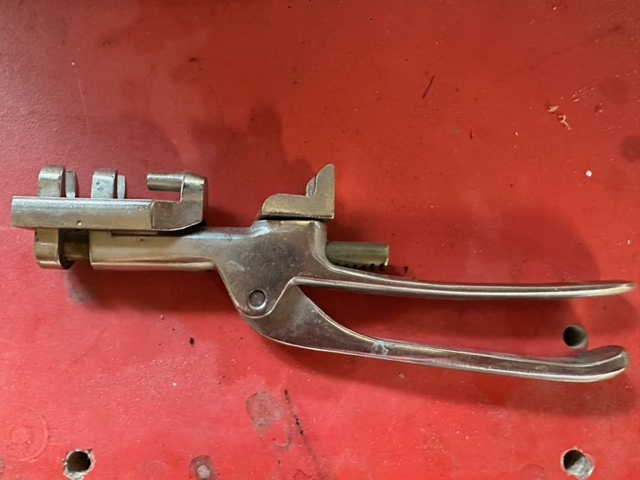

    It is easy if you happen to have the right tool, a pliers design Jurgen used to sell from pianoforte supply. but that is no longer available anywhere. Also not so hard if you have the more archaic Hale tool, plier/gear design, made to remove both grand and upright hammers. If you know someone you can borrow such tools from, do so (If you were around Albuquerque, I'd be happy to lend you mine).

    I've removed sets of hammers to save and reglue several times, using the hefty pliers Jurgen used to sell (and they are no longer being made). With their compound leverage, they make the job easy and quick, and they come quite close to being a right angle action.
    True right angle (force of the pin in line with the shank) is achieved also with the Bolduc side voicing tool (it has an extra plunger for the purpose) and the Hale tool that works for both uprights and grands (but disappeared entirely about ten years ago). The Bolduc tool doesn't have as much leverage, but works pretty well otherwise.
