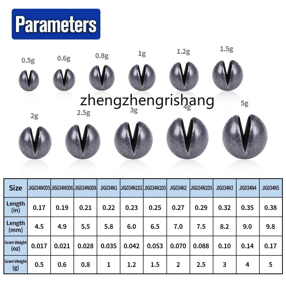

    I wonder if split shots could be adapted to your needs. Below is a chart of the approximate diameters of split shots. They'd be cheap and malable via hammer or pressing with pliers.
    Approximate diameters by common split shot size (metric and imperial approximate ranges):
    • Size 000 (3X) - ~3.5–4.0 mm (0.14–0.16 in)
    • Size 00 (2X) - ~4.0–4.5 mm (0.16–0.18 in)
    • Size 0 (X) - ~4.5–5.0 mm (0.18–0.20 in)
    • Size 1 - ~5.0–5.5 mm (0.20–0.22 in)
    • Size 2 - ~5.5–6.0 mm (0.22–0.24 in)
    • Size 3 - ~6.0–6.5 mm (0.24–0.26 in)
    • Size 4 - ~6.5–7.0 mm (0.26–0.28 in)
    • Size 5 - ~7.0–7.5 mm (0.28–0.30 in)
    • Size 6 - ~7.5–8.0 mm (0.30–0.31 in)
    • Size 7 - ~8.0–8.5 mm (0.31–0.33 in)
