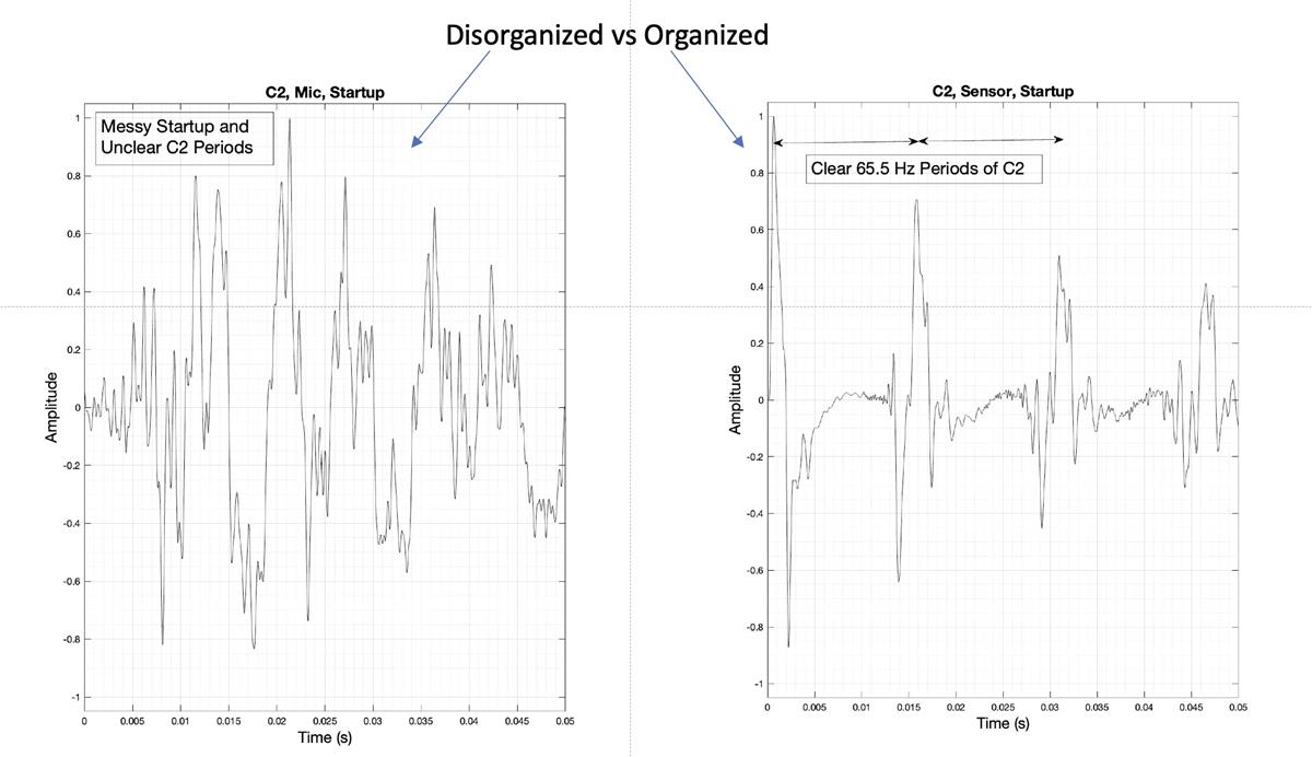

    • There is a widely held 'myth' called 'the missing fundamental' in the bass register of a piano.
    • * This myth is very unfortunate and very untrue.
      * I am here today to dispel that myth once and for all with irrefutable evidence.
      * Is the fundamental present all the way down to A0. Of course!
      * This evidence was collected from a PianoSens sensor on a large concert grand, a Fazioli F308. However, I did a similar experiment over 15 years ago using an instrumentation quality microphone on a Steinway D and got a similar result.
      * As you watch the video and hear the explanation, you will clearly and unequivocally see that there are clean, pristine periods of repetition at the fundamental frequency all the way down to A0.
      * You will see the spectral view of the time domain showing that the fundamental A0 is down only 9 dB from the 2nd harmonic A1. A factor of 9 dB is still very easily heard by human perception even at that frequency.
      * I also show just how 'messy' the transient response is from the hammer strike moment, compared with the PianoSens sensor.

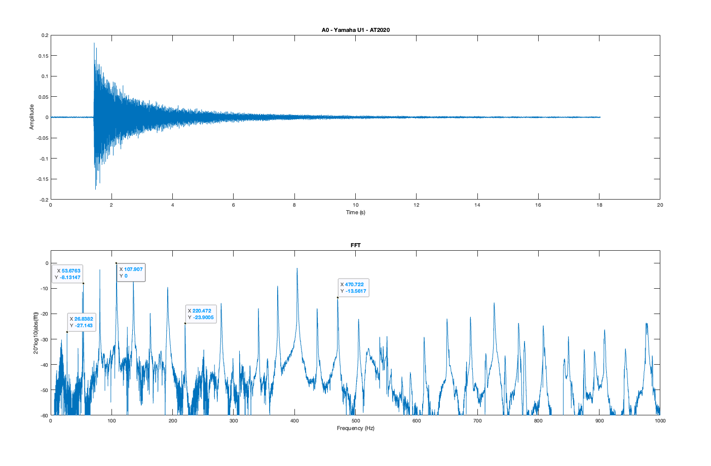

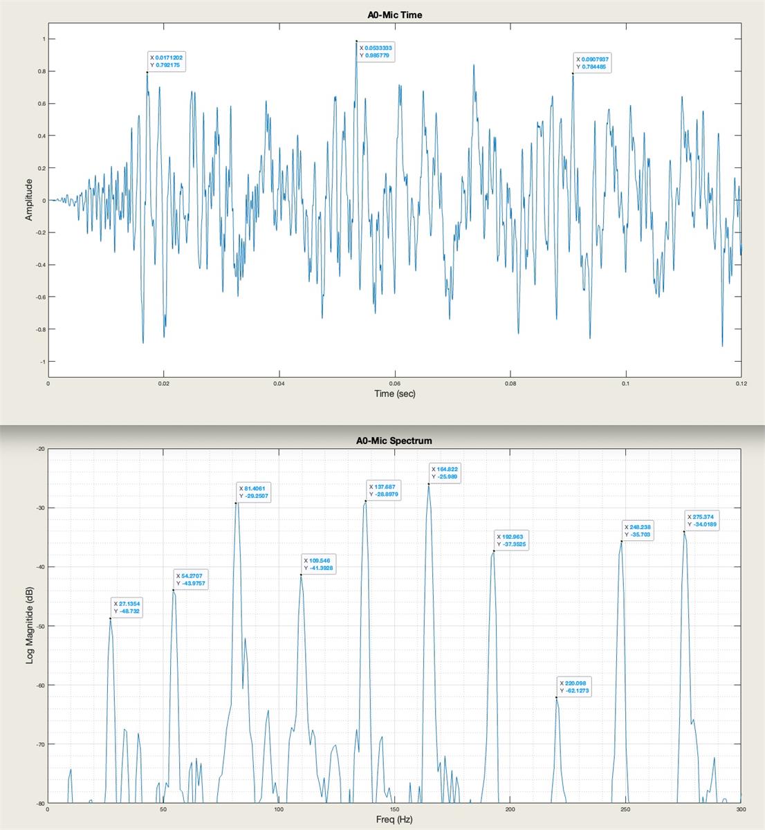

    Peter has 'challenged me' indirectly (ha ha) to do the A0 with my Neumann KM183 mics. Then I use the same parameters of Matlab as I did before when I captured the A0 with the PianoSens sensor.
    The pic is below. Double click it to see it better. The top view is amplitude vs time. The startup is messy compared with my prior presentation using the sensor, but there are still very clearly defined periods of A0 that I have marked.
    Now look at the spectral view on the bottom. Look at the 3rd and 6th levels as the highest of the first 10 harmonics, but look at the fundamental which is only 5 dB below the 2nd harmonic. Amazing. So, it all boils down to how to set up the experiment and how to perform the frequency analysis.
    Steve

    Ed Sutton wrote, "The piano has little capacity to transduce a 27.5 Hz vibration into sound waves, and the human ear has limited ability to transduce a weak 27.5 Hz signal into a perceived sound." This hits the nail on the head in my opinion. I don't think anybody is saying that a (roughly) 27.5 Hz wave doesn't exist on the vibrating string of A0. It clearly does. But it's unimportant enough that we can ignore it.
    Just for fun I recorded A0 on my Yamaha U1 using a ~$100 AT2020 condenser mic. (Not recording studio equipment, but probably better than most human ears) Here's the frequency spectrum, plotted on a dB scale.
    You can find a 26.8 Hz "fundamental" peak about 27 dB below the strongest "4th harmonic" peak, which is something like 7-8x softer. But that doesn't take into account the human perception of loudness. Even if the fundamental were as strong as the 4th harmonic, we humans would still hear it around 40-50 "phons" softer. There's no point IMO in trying to tune a harmonic that no tuner, pianist, or audience will ever hear.
    Another consideration: a couple people have mentioned difference tones...that we can perceive a 27.5 Hz tone even though the first harmonic is basically absent. Those difference tones come from the interaction of higher harmonics, and those higher harmonics are more widely spaced than lower harmonics because of inharmonicity. In fact, when I take the autocorrelation of the FFT of my sample, I find a peak at 27.6 Hz, a full 48 cents above the "fundamental" frequency of 26.84 Hz. Admittedly I'm out of my depth here, but I would speculate that the difference tone would be more audible than the fundamental.
    To be clear, I'm excited to try out Pianosens for several reasons. Detecting the missing fundamental isn't one of those reasons. I'm more excited about being able to ignore the leaf blower outside, which, of course, was present when I made the attached recording.

  • 36.  RE: Dispelling the 'Myth' of the Missing Fundamental
    Posted 01-24-2024 20:09
    Hi Steven,
    Most of the prior art does not take into account the ‘linear’ and the ‘nonlinear’ aspect of the harmonic analysis. Perhaps you saw my explanation on the nonlinear aspect which causes the sum and difference frequencies, whereas the linear model does not cause this sort of modulation.
    I’ll check them out.
    Thanks.
    Steve

    Here is an apples for apples comparison on C2. The first 50 msec transient startup in the time domain. Look at how messy the situation is acoulstically with the mic vs the sensor. There is nothing wrong per se with the mic. It is the string getting the whole acoustic 'system' going in the bridge and soundboard that is making things incoherent. This has been what we use up to the current date for feeding our ETD's. Every pickup point of the mic will have a different view and hence a different representation to the ETD. The frequency peaks of the underlying waveform are still there but harder to discern with a mic or with the human ear, causing large variance position to position.
    Double click on the image for a better close up view.
    Respectfully submitted,
    Steve
    C2 transient startup
