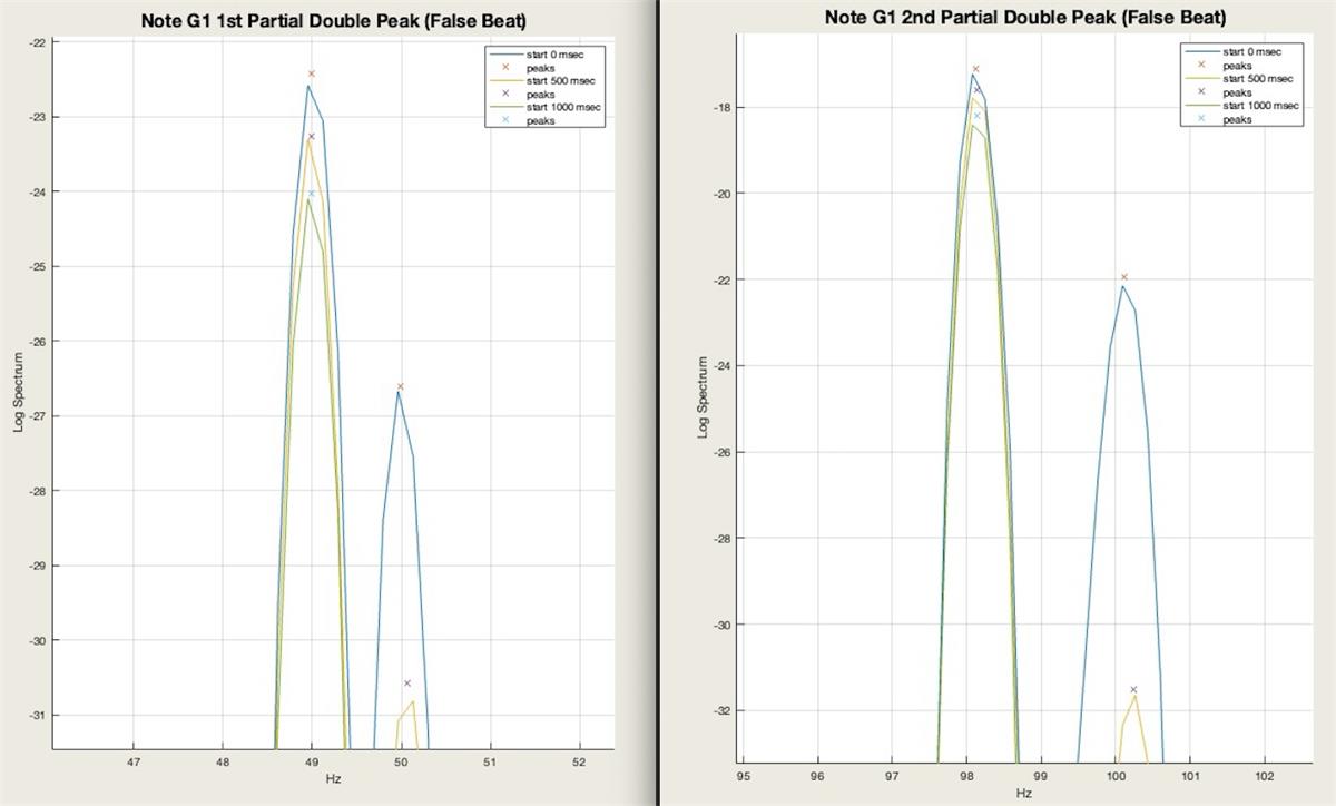

    (Again, non commercial interest, no product or app promoted or represented).

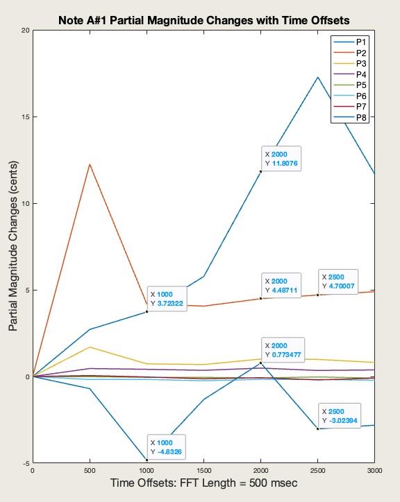

    The false beats of the low notes are slow enough to be mostly inaudible but they are smearing up the app's ability to measure them. If the app uses zero crossings, it would produce lots of false crosses at the double peak frequencies that are so close. The app would not have the ability to separate them unless it used super high resolution FFT's. Here is an example of the note G1 on a concert grand. Notice the double peaks are only a couple Hz apart and only a few dB different in magnitude. This is a real problem and the errors are huge on most apps.  A very long FFT is the only practical answer.
    Double Peaks

    Except that no ETD is ever going to look at the 1st partial of G1 down at 50 Hz. If it's Cybertuner being discussed, I just pulled up their manual and it looks like for G1 they'd be using something from the 6th to 12th partial. (See Page 19.) Zero crossings should be significantly more accurate in that 300-600 Hz range.
    Anthony Willey, RPT

    Posted 03-20-2024 23:52
    If you are measuring IH accurately you may want to look at 50 Hz and above.

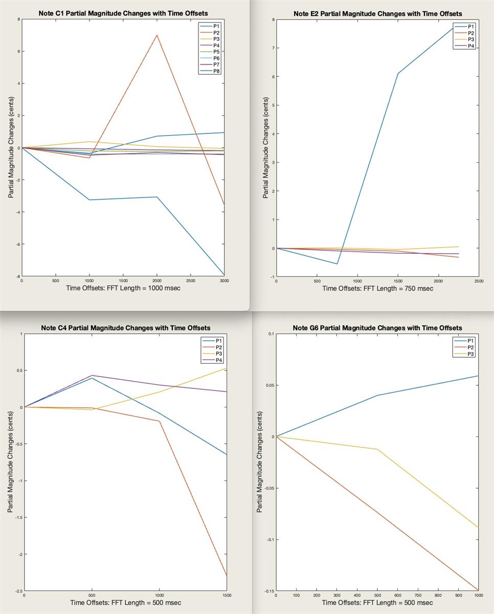

    No one out there seems to understand the Freeze frame concept. It's up to the inventor to explain.
    No, the Freeze is not a snapshot, it is window of time from the hammer strike to about 700 milliseconds thereafter, where that 'average frequency' is measured over that duration of time window where the signal power is highest. There is no such thing as an instantaneous frequency measurement in zero time.
    The real 'driving force' for the invention of the Freeze frame window is that the 'pitch' also decays as the amplitude decays. Can any human watch a continuous reading and remember were the pitch was consistently? No. The Freeze indicates that, and it is the ONLY consistent way that has ever been described or reported.
    The piano decays in amplitude about 20 dB / sec in the mid range, and about 20 dB in 300 milliseconds in the upper register. Tune where the power is the highest, in the first second. The piano not only decays quickly but the human absolutely cannot perceive the pitch accurately in the first sec, nor can most any ETD, 'unless' it integrates it over that time using an FFT.

  • 31.  RE: First tuning experience using PianoSens
    Posted 03-22-2024 23:06
    Partial Drifts Over Time Windows. Easy Proof of Freeze Window Tuning in First Second.
    I don't like conjecture. I like data, and the data speaks for itself. This is the scientific method.
    See figure below. Showing C1, E2, C4, G6.
    Comments:
    C1: The fundamental and 2nd partial go in opposite directions and have large deviations that 'do matter'. So tune early and deterministically. Easy provable conclusion for the Freeze Time Window concept. Need say no more. Use it. Medium blow.
    E2: Fundamental goes wildly sharp (not flat!!) during the 750-1500 ms range. Same easy provable deterministic conclusion. Tune in first second.
    C4: The 2nd partial goes flat quickly while the fundamental rises to 0.5 cent from the 500ms - to - 1 sec range. Same conclusions!
    G6: Very little deviation after a couple secs. The high register on my Fazioli F308 is extremely great and steady sustains of freq over time.
    Steve
    Partials Drift Over Time
    Steven Norsworthy
    Cardiff By The Sea CA
    (619) 964-0101
  • 32.  RE: First tuning experience using PianoSens
    Posted 03-23-2024 01:59
    Graphs like that can be a bit misleading. It looks like the pitch at the beginning is defined as "zero" and then you're measuring the deviation from the there. In my experience the pitch is always at its most wild in the moment of the attack, with the partials going in every direction. If you define that initial attack wildness as "zero" then of course the lines on the graph will appear to diverge during the decay. The graphs I'm used to seeing have the lines all over the place at the beginning and then converging during the decay. But those graphs came from notes measured with microphones...maybe things are different with the sensor.
    I'd be curious what the graphs look like if the cents deviation is measured not from the initial attack but from the detected pitch from a long FFT of the whole note.

  • 47.  RE: First tuning experience using PianoSens
    Posted 03-20-2024 22:01
    (This is not a commercially oriented reply... there is no mention of any device or app).
    An app should give a 'resolution' time window that is consistent and represents where the max energy lies, in the first second or so after the hammer attacks. The pitch changes partial to partial very dynamically vs time. Here is a recording and measurement I did in Matlab so that I was not using any commercial ETD app. This is an objective example. Notice a huge deviation of the first and second partial from a 500 msec offset of the initial 500 msec window. Every note has a different characteristic in this way. So if the app doesn't give you a repeatable window of time to resolve the pitch within the window where the max power lies, then it is all 'guesswork' because it becomes a black box and there is no way to know.
    Steve
    Partial Pitch Changes vs Time for A#1
    Steven Norsworthy
    (619) 964-0101
