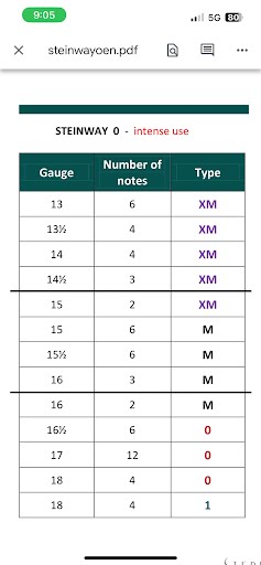

    I am apprenticing with a very seasoned rebuilder in my chapter.  He is teaching his grandson and me his rebuilding method on an early 20th century Steinway model O. He was not familiar with Paulello wires, but would like to try them (I used them with great results on my own rebuild).  Paulello has hybrid stringing formulas on his website. Below is the "intense use" version for the Steinway O:
    When I input the speaking lengths from the Steinway manual into Paulello's typogram, I'm puzzled at the results.  Using type 1 on the four lowest tenor notes (B2-D3) puts the breaking tension of C#3 at 66% and D3 at 70%. Using type 0 would put the same notes at 52% and 55% respectively which falls into his recommended parameters. Why type 1 here?  While we are mainly trying to make improvements to the low tenor and will likely use regular wire in the upper treble, I'm wondering why Paulello suggests using XM in the highest treble (F#6-C8) which only puts the breaking point between 50-60% when the typogram recommends this range being in the 70=+% range? Type M makes most notes in this range fall in the mid 60% range which is still below what he recommends.  His "normal use" suggestions use type 0 throughout most of the keyboard and type M for D#7-C8).  It seems that there is no happy medium here and I am not familiar enough with hybrid scaling theory to wrap my head around the reasons for these seeming discrepancies.

    I think one key to answering your question regarding the scale that you posted are the words "Intense Use"; at least with regard to XM in the high treble. Your questions are good ones and it is possible that Paulello has changed his thinking a bit and not changed his Typogram spreadsheet. Certainly Type 1 would be good for notes 27 and 28. I would probably switch to Type 0 on note 29.
    You likely already know this but Paulello Stress % is different for what is generally considered as Break % and Paulello Stress numbers tend to run higher than traditional Break % numbers as calculated by the late Dr. Albert Sanderson of Inventronics and Dave Roberts of The Calculating Technician. As I understand Paulello Stress % numbers, they are the optimum state of elasticity for his wire.

    I took to heart that the PBL% is the  most important variable, and learned that holding to moving into or remaining in the Goldilocks Zone is always going to give me predictable and pleasing results aurally.  Like the other variables, smooth and close transitions are to be desired.  For the most part, there is little to no conflict between PBL% and the other variables that we attend to.  Either way, the piano always tells  you what the limits are, but you have more options with PBL% in the mix.
    Over time, I have learned that there is more flexibility in how the wire is used than I had thought.  The essence of it is, as long as I stay within my defined parameters for PBL%, usually more than one wire type can be used successfully, although each wire type will bring its own changes to the tone of a particular note.  For instance, note 27 on the O in discussion could be strung with Type M in a conservative scaling - M is more or less the equivalent of Roslau or Mapes wire.  Using Type O will raise the PBL% without changing the other parameters and will improve the tone because that breaking percentage is closer to the Goldilocks Zone.  Moving to Type 1 brings the PBL% into the GZ, and sounds the best of all.  But each of them work and are acceptable to the ear.  I have rebuilt many O's and L's over the decades, most with original scaling, then to rescaling with traditional wires, and finally to hybrid scaling.  In hybrid scaling, I have variously taken Type O up to about 39,  low 50's, and as high as note 78 before transitioning to M.  Each of these methods work and will produce a slightly different sound.  Similarly, I have used Paulello's intense use scale, with XM wire for the top 20 notes.  The scale does not necessarily call from XM (as some other pianos might), but it does give a different sound, more relaxed and less stressed sounding.
    John Schienke asks that you specifiy Paulello cores if you want them, and charges extra for the use of the materials.
    i have never used the Typogram other than to play with it, because I am flying blind with all the other variables that I want to attend to.
    So Tim, the answer to your original question is that both XM and M will work in the upper treble.  If the O of which you speak is situated in a concert setting of heavy use and heavy hands, the XM would be the ticket .  Or you might choose it for reasons of tone.  In a normal household setting, the M would be the ticket.
