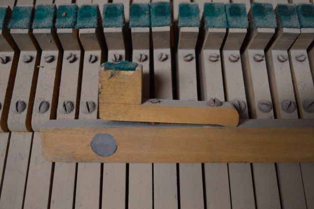

    To start I had no idea how pianos work until I got this piano. but I am not afraid to teach myself new things.
    Had the chance to get this square grand piano, My wife fell in love with it, most of the keys did not work but I said how hard can it be ... *que laughing* If anyone has any information on this particular brand that would be swell, so far my research has taken me to that they were a piano retailer and maybe had someone else make these for them. They won some awards at the 21st Ohio state fair best square piano silver medal. found in the 26th annual report of the Ohio state board of agriculture.
    So far I have replaced the back rail felt, balance rail felt, front key felt, hammer rail felt, replaced all the thread on the jacks, replaced all the dampers, (not period accurate dampers as i have learned after reading many threads on here), I fixed one damper arm on the piano.
    what I still need to do is replace the 2 last missing treble hammer assemblies, eventually replace all hammers and all strings. For right now I am just trying to get this to play well enough for my wife to enjoy, I have done two tunings on the piano so far at A435 seems to hold tune well just still slightly flat (piano has been sitting for many many unknown years)
    Questions I have. I have a substantial gap below the nameboard and the keys, as well as when the key is depressed the key sits 1/8 to 1/4 above the front rail cloth and the jack is just pressed up against the jack stop button. and I get roughly a little less than 3/8 key dip so far. MY guess is the back rail cloth is too thick that I got as the piano had little to no felt so I had no examples to go off of. If I add more punching's to bring the key height up I will have even less key dip. I am just unsure where to start to get this piano as good as I can knowing it will not be perfect.
    Below is a link to all photos I have taken so far and will update the album as i add more.

    First of all, my "condolences" to you for taking on a project like this. Very few full time piano technicians even bother working on square grand pianos, much less doing any major repairs. So kudos for that.
    Second, your wife is going to owe you "big time", for encouraging you to tackle this job in the first place. At least when you get done you know you can keep it.
    Now, to the technical part. Again, the first thing I would do is get a solid door, 3' x 7', to put on your table so that the action will sit flat. Having the ends of the keyframe dangle over the edge of your table makes it very difficult to do any kind of regulating. When I did a job like this, even I had difficulty regulating the action on a large, and I had a big, flat work bench.
    Now to the exact question you asked about. Key dip is the first step in regulating an action. You said there is a gap between the tops of the keys and the rail across the keys. (I saw the picture). That is the first step you should do. Key height and key dip are a balancing act. You need enough back rail felt and balance rail punching to lift the keys up high enough to get a little more than 3/8" key dip, (filling ion the rest with front rail punchings). But not high enough not to allow the rail to go across the keys. Since you didn't have a sample of the back rail cloth, you have to experiment with different thicknesses. You want to keep in mind that you also need a thin felt balance rail punching under the middle of the key.
    Once you've got those dimensions figured out and working, then the fun starts, regulating the action.

    So probably the best course of action is to remove the hammer assembly and just work on the rail felts/punchings to get the proper height and key dip then put the hammers back on then regulate the lost motion with the jack and then the jack stop. I just measured and lots like I have the hammer rail height ok all sitting about 2" below the wire. I attached nother video to the Google album for better visual of the key drop and not hitting the felt punchings.

    I'm rebuilding a square right now. Just finished the soundboard work, rescaled and restring. Just starting on the action.. If you want to trade labor for training, I'll show you how make these thing work.  Also go to my YouTube channel and find the square piano Playlist ,I believe there about 10 videos on squares.

    Hello, thanks for the reply, I texted you a couple times on this piano :-D I've watched quite a few of your videos. What did you have in mind for trade labor vs training?
    If you see some of the videos on my google photos she is now playing but I know I can do better :-)

    Not all rockers are the same style. Most that we find in American squares and grands have a rounded fulcrum between two screws, which means both screws must be turned when any adjustment is made.
    This French design (from a Montal pianino) has a much more user friendly design. The front retaining screw (round head) threads into the key, and secures it. The other adjustment screw simply presses against the wood of the key, making its own dimple. The dimple is sufficient to retain the side to side position, when the adjustment screw is positively contacting it. For small adjustments, you only need to address the adjustment screw, as the elasticity of the wood of the key will keep the "rocker" secure. Occasionally you might need to tighten or loosen the retaining screw.
    Once I saw this for the first time, I wondered why anyone would use that pesky American design. This one doesn't rock. It just lifts or lowers.

    That one looks like it's a bit easier to adjust, Mine is the other french style. Still not terrible making adjustments. After doing some reading I do need to go in and make some more adjustments with some paper shims for left right motion to square up the jack under the hammer.
