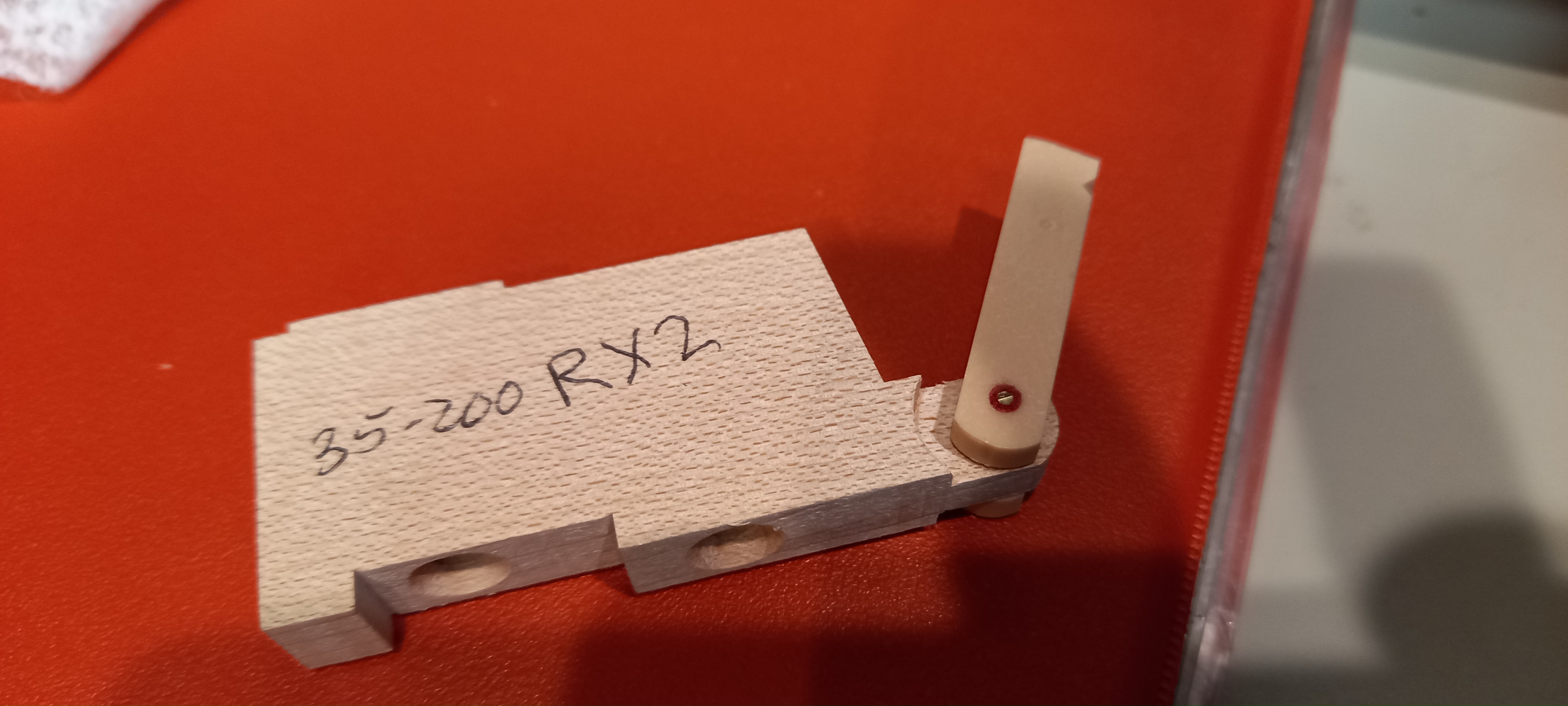

    So I went out to a church way out in the boonies (an hour away from my house) to help them diagnose a damper problem.  I pulled the action out and determined that the 2 extreme side pieces on the lifter assembly were non-functional. The pedal actually lifts the bar and most of the dampers will rise, but the bass dampers stay down. Some tooner had tried to fix it by putting a rubber band around it to hold it in place.  It looks like an oversize flange and I think the pin has worked its way out on each end and the rubber band is some sort of stopgap to keep the pin from working its way out.  I enclosed a picture with the flange highlighted.
    By adjusting the pedal rod, I was able to get the bar to lift the bass dampers just enough to sustain.  It is a very temporary repair.
    So to fix it, do you all think I should get new "oversize" flanges to hold the side wood pieces stationary?  Also, do you know where I can get those sorts of parts?

    I can't quite figure out what the problem is, but it looks like the rubber band is holding the lever that holds the tray to the flange. Maybe the screws that hold that lever are loose. Or, perhaps the flange that holds that lever to the back rail is broken. It doesn't need a bigger flange, but you might have to repin the flange with a thicker center pin).  In either case, it might be necessary to remove all the dampers and take the whole back action out to see what the real problem is.

    Thanks again Larry.  I got hold of Kawai and they are sending me two new flanges/blocks.
    The current part number is 35-200 RX-2
    it took them a few hours to locate the part in their warehouse.
