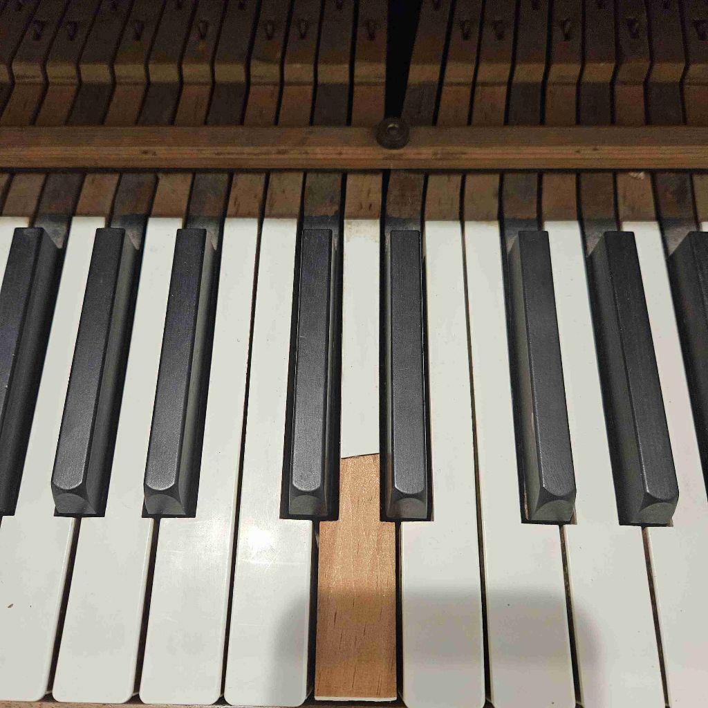

    Well, we all come upon "firsts" even if we've been in the industry for some years...so forgive me, but
    This will be my first keytop repair/install. Customer is missing this keytop so I will need to remove the broken piece and install a new plastic key top for this one note. Assuming I had no tools whatsoever, what all will I need as far as tools, supplies, equipment, anything else? Provide an exhaustive list please, I love detail.
    Thanks folks.

    Chisel
    File(s)
    Small clothing iron
    Keytop Glue (not contact cement), PVC-e, Eileen's Tacky Glue
    Rags
    Keytop replacement(s)
    White-out/paint
    Chisel off the remaining keytop.  If necessary, you can place a damp rag over the keytop and heat with an iron.  This will usually soften the glue.  Chisel off any remaining glue on the keystick.  If you're replacing ivory, paint the keystick with white/out, then put glue on top of it.  Ivories are translucent, so you want white color underneath.  It will be challenging to match the color of white that the piano has.  On older pianos, you can get off-white color keytops.  There are imitation ivories that look like the real thing.  Spread glue on the keytop and put into place, centering it.  You'll use a file to remove the excess overhang on the sides.  Also, there are short and long fronts on keys, so be sure the keytops you're replacing with match the size of the originals.  When you install the new ones, you'll most likely have to file the keytop so they match the notch in the keystick.  Wait for the glue to dry before doing any filing.  You can sand/scrape/buff the edges of the keytops so they're slightly rounded.  Be sure to match the lip overhang when you glue the keytops on.  Using any of the Sobo-type glues won't require any clamping, just press them down and let them dry.  On your job, you'll need keytops that don't have fronts molded on.  You can get keytops with or without fronts.  You "can" use with fronts if you want, but you'll have to shim out the keyslip so they don't bind there.  If you're doing ivories, and an entire set, you'll have to shave down the keysticks because the plastic replacements are thicker than the ivories.  That's a whole 'nuther ball o'wax.
    Good fun, have luck.

    The hardest part of this job is to match the new keytop with the others.
    To replace the new keytop, you will need to remove the key from the piano. Once you've got it out, use a chisel to remove the old, broken keytop. When you put on the new top, make sure the front of the keytop lines up with the front of the other ones. When this happens, however, the notch might not line up with the other. It's more important to match the front, and then use a file to make the notch fit. You will also need to file the side of the keytop to the side of the wood stick.
