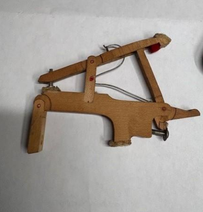

    Good morning all.
    Does anyone have an idea where I can source jacks for a kranich and bach grand?  I thought I had a replacement with some jacks off an old Weber, but they do not have the extra material on the base (to connect it to the jack return spring), so I can't retrofit it.
    Patrick

    Somebody already did this.  Might have to do rob 4, 5, 6 and 84, 85 and 86.  I wonder if I could retrofit some other old whippens to make them work?
    Edit number 3.  stevespianoservice.com had them at one time.  This particular jack is 1" from the hole to the end of the jack arm.  Steve still has the 1 3/16" long arm.  Do you think I could make that work?  It would poke out a bit in the front...

    Get out your two wippen kits find the closest match and install new wippens. Stop the snowball by at least having reliable wippens. You most likely will have to make new heels, keep the original flanges and you may even have trim the front of the rep lever. Verify it on an action model. Thats how i have retrofitted some of these odd designs.

    I have an old Knabe action and the jack on that is similar to the Chronic (what I call it) jack.    And yes, this is a little start up church with limited funds..

    I found someone who has 90 of them for sale on Ebay, but the jack toe looks to be 1 3/16" versus the 1" that I need.  Do you all think this would still work?

    Not without changing the let off buttons. And even at that, that extra 3/16" might be too long.

    Hello Tremaine.  These Whippens are approximately 85mm from whippen flange center to jack center
    Would you sell me some of your whippens so I can cannabalize the jacks?

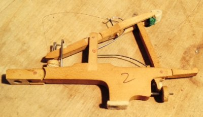

    Well, according to my Schaff catalog I believe you are looking for Kranich Short Arm Jacks and mine are Long Arm
    Mine if I can find the box...
    Yours

  • 20.  RE: Kranich and Bach jacks
    Posted 06-18-2025 16:12
    Mine

    There is a piano rebuilder near me who said he has two K&B grands in his warehouse awaiting a rebuild.  He said we can go out there and pull the grand action out and he will sell me some whippens.  I am hoping he has a short arm, but if not, hopefully I can trim 3/16" off to make it work.  I am going to pull the good ones that are left out of the lower bass and upper treble and replace the bad ones with whatever jack I can get hold of.  It will probably be better than a b@sterdized Knabe jack.
