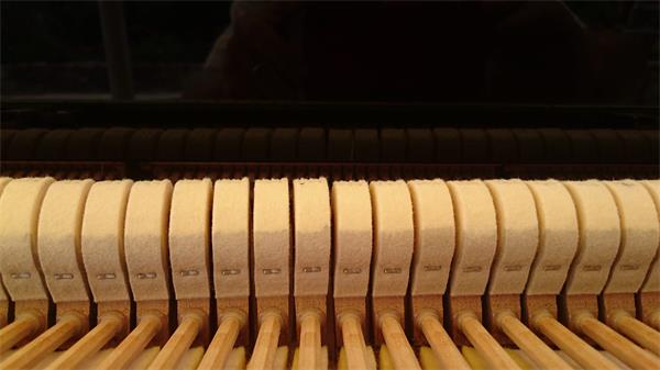

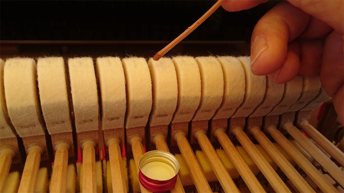

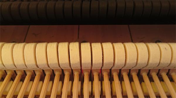

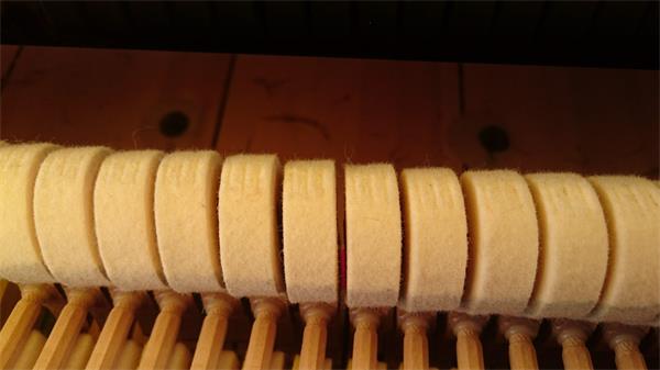

Last week I came to another instrument which not only sounded hard but had very visibly degraded hammers. I sanded but not completely removed the grooves
https://www.youtube.com/watch?v=feW_mPE73ks and, to bring a swelling of felt in the middle of the hammer, applied one drop of Vodka to the centre groove. The video documents the result.
Any thoughts on sanding technique would be appreciated. What I'm doing has achieved success but could it be better?
When sanding with a strip of sandpaper I've found that if I use a strip only one hammer wide, it's easy to slip out of line and skew the draw across the felt.By using a paper 1 1/2 hammers wide, I might do only 1/2 of the adjacent hammer, which is then corrected on the next but this keeps the draw of the paper straight. Perhaps it would be better to do it with double width strips?

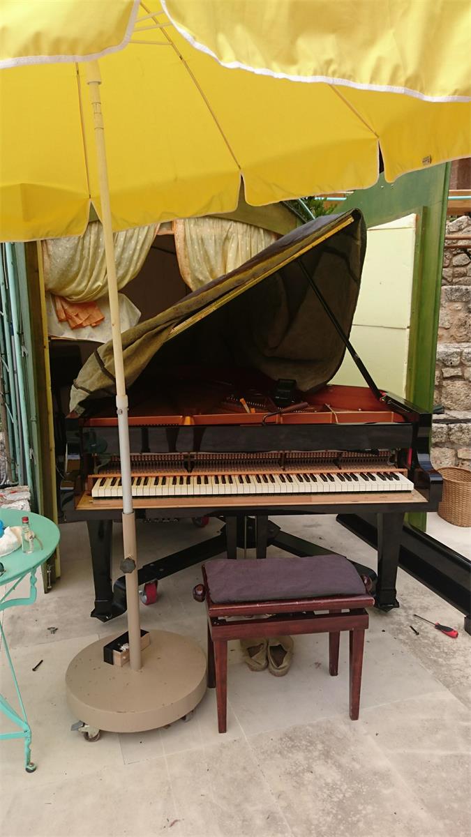

An instrument in Greece gave me a hard time recently. Thanks to all who advised on electronic additions to the action. That might be the subject of another thread in due course.
The venue was an outside amphitheatre and the instrument was kept in ideal climate controlled conditions off-stage.
