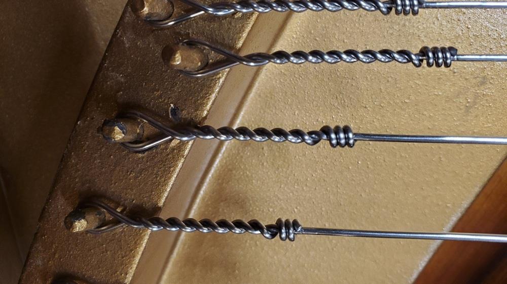

The replacement strings sound great, and it looks to me that it was the excessive swaging that had weakened the strings which resulted in the dead tone.

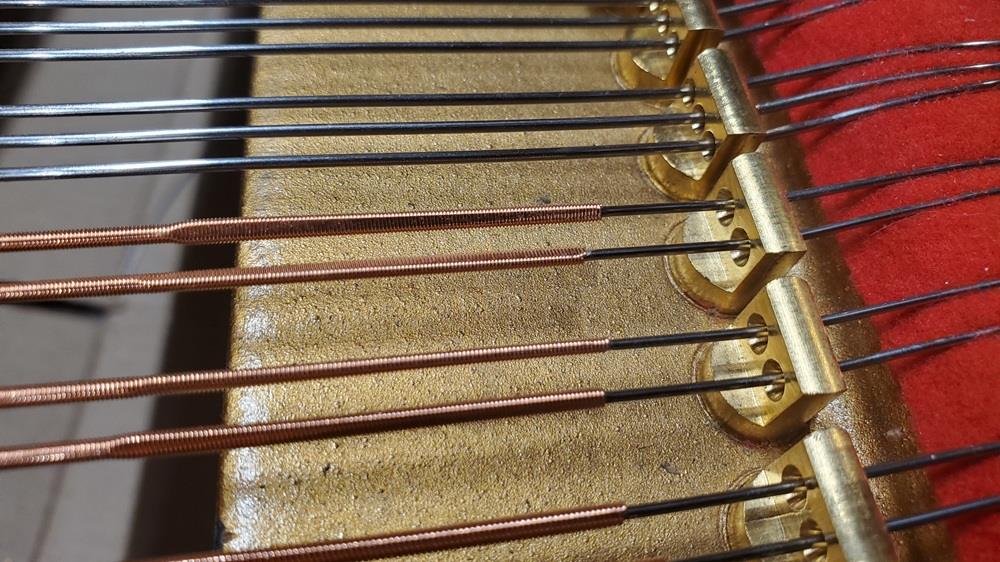

The replacement strings have the exact same I.D and O.D., I'm now concerned......

Interesting post because I was thinking about ordering a full set of bass strings from Mapes . My guess is that the strings you have are defective or not the correct ones for the piano . Did you do a string tracing of the old strings before removal as well as micrometer readings, Winding measurements etc or did they say they have the scale for that model ? Maybe strings got mixed up and can not be brought up to the required pitch .? What brand and model piano .

What causes a bass string to sound great right up until the pitch is reached? I'm installing a new set of Bass String from Mapes. Two unisons( 4 strings) next to the steel.
They get a thuddy sound right at pitch, i lower the pitch and they sound good again. All the other strings sound good --uni@1 full twist, bi-@ two full twist. A friend of mine says he always did uni@ 1 half twist, and bi@2 half twist. No instructions to verify on Mapes website (they should fix that).
This is the first time i have used mapes in 3 years since the previous disaters after the new crew started. Now i'm starting to regret using them again.
But still, what causes the above mentioned string behaviour?
Thanks in advance.
