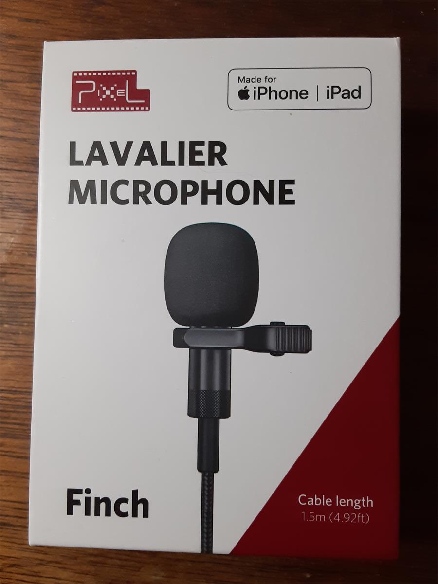

    A recent thread was touting the wonders of a new pickup for ETD tuning that solves all problems and hears the worst notes perfectly.
    I decided to experiment.  I found the microphone below (only $7.95!) and today I tested it on a nice Kawai grand.
    Without the mic the pitch was A 439.2, with the mic my iRCT indicated that the pitch was G# 4.
    Good idea... Didn't work.

    So, using an external mic did not prove to be more accurate than the internal one.  The app should have indicated A4.  That's quite an error!  I hope you get your $7.95 back.  You won't get that kind of error with a sensor.  Maybe your mic was close to some aliquat which was mistuned, who knows.  Interesting experiment..

    Microphones are used 10's of thousands of times a day to amplify and record music. A microphone changing the pitch is not a known problem.
    Your Pixel/Finch mic has a lightening connector and they have circuitry built into them, perhaps there's a glitch there. I would experiment with it more to verify that it's not user error.
    I have a lav. mic that connects through the headphone connector on my iPods (Veritune) and have used it many times in noisy situations with no problems. I know some people use them all the time with their ETD's .

    That mic costs $38 on Amazon, maybe you got a counterfeit.

    I tried recording voice with it and it works perfectly.
  • 6.  RE: Microphones
    Posted 01-07-2024 02:08
    Actually, I did check my bill and it was $38, but I am trying another one for $10 with a different input plug.

    From the Amazon listing for this mic...
    "To reproduce clear and consistent sound, there embeds noise filter and cancellation chip inside the microphone for iPhone video recording."
    Who knows what kind of games this mic is playing with the sound from close micing a piano?
    Find yourself a free spectrum analyzer app for your phone and compare the difference between this mic and the built in mic on your phone. I'll bet there will be much strangeness between the two. I'm curious to know so please post back.
