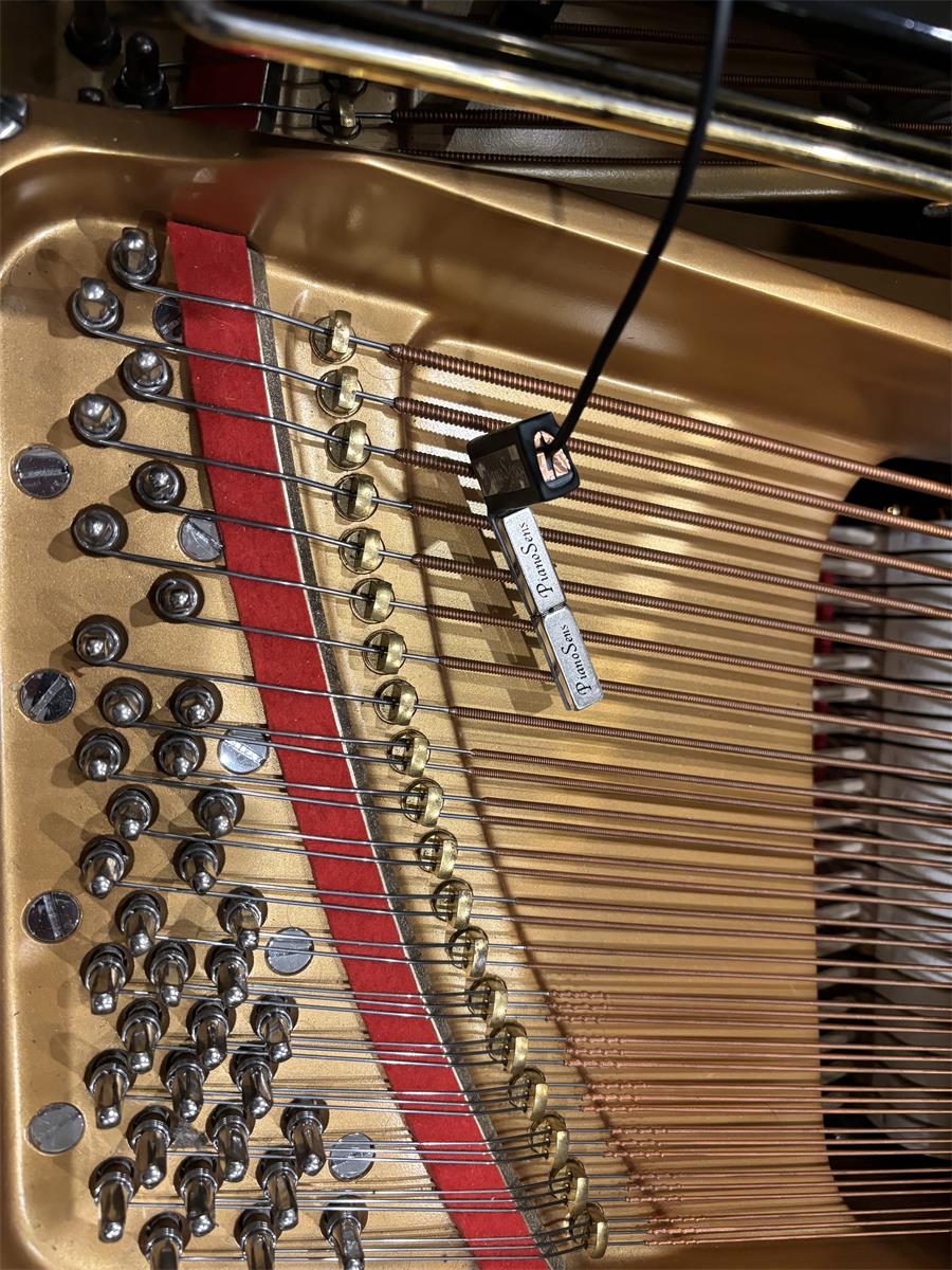

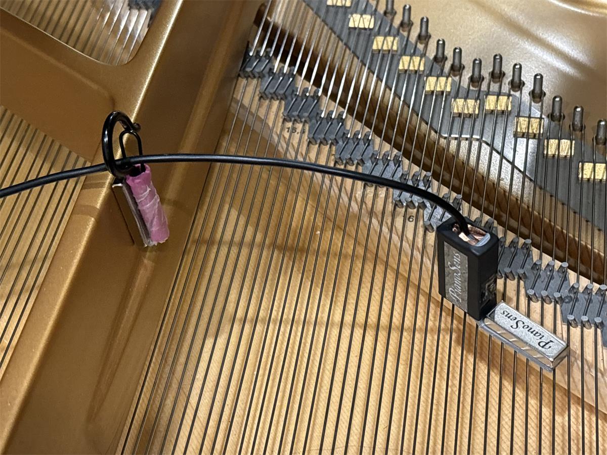

    This problem led me to invent the PianoSens device. It is not just a 'guitar like pickup.' As an EE, I solved many problems doing this design.
    I place the sensor < 1/8th string length to pick up all the partials > 8 partials, and making small movements of several centimeters in this 'region' and it has literally no discernible variance, which is loically to be expected. You can see small amplitude differences, of course, but not much. Tuning variances are now about 0.1 cents, not 1 cent.

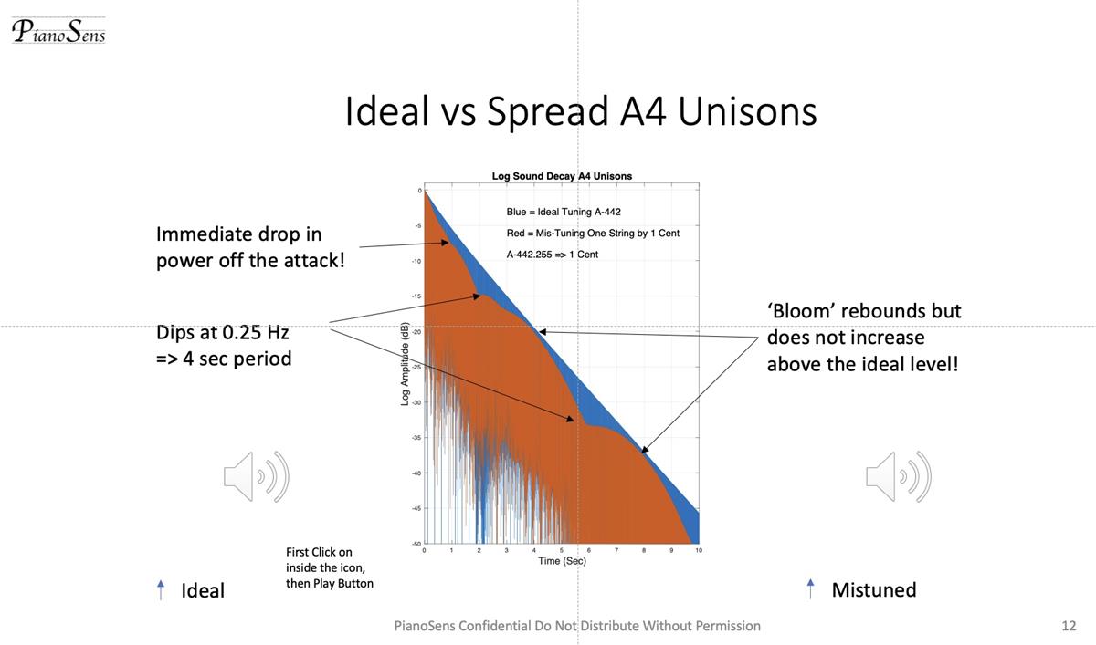

    So here is my latest example. What do you think? It takes 2 mins to watch. Thanks! Prof. Steve
    Example of greater high partial information, spectral purity, and tuning accuracy with sensor vs mic
    Far greater high partial information, spectral purity, and tuning accuracy is achieved with sensor vs mic. This indeed affects the tuning accuracy measurement achievable in an ETD app. The PianoSens sensor captures far more energy in the higher partials or harmonics. This results in a greater signal-to-noise of the waveform, and therefore more accuracy in the frequencies. In this example, the difference is as much as 0.6 cents but on some notes it can be greater than 1 cent.
    YouTube video below.
    Low Frequency Spectra: PianoSens vs Microphone
    YouTube remove preview
    Using the PianoSens sensor we are able to get more spectrally pure information that affects the tuning accuracy measurement achievable in an ETD app. The sensor captures far more energy in the higher partials or harmonics. This results in a greater signal-to-noise of the waveform, and therefore more accuracy in the frequencies.
    View this on YouTube >

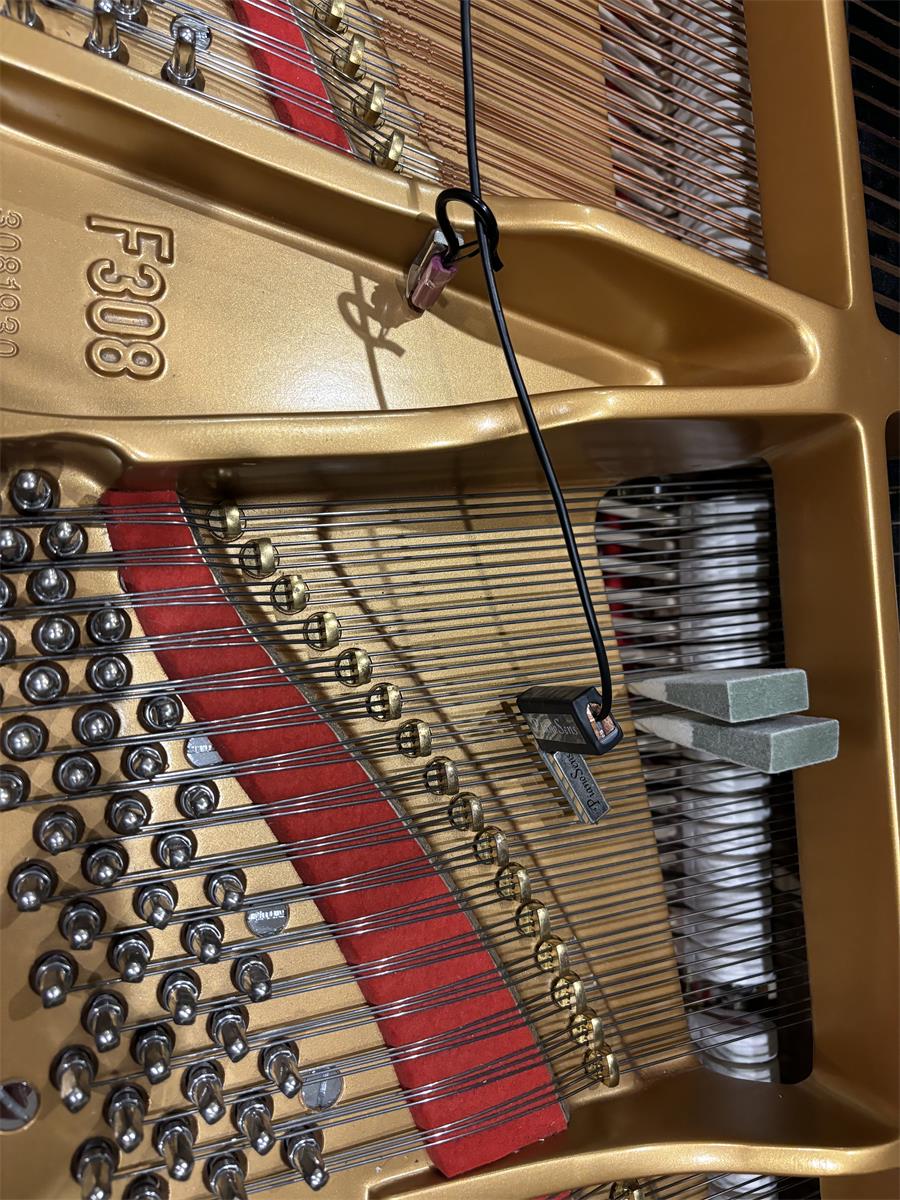

    Listen to my post of a few mins ago…. on Pianotech
    I think that answers things… do you hear beats? How much?
    Demo of a PianoSens tuned Fazioli F308 using 8ths, 12ths, 16ths

    By the time you wait for a crossover, the frequency structure has drifted flat due to the natural FM effect. Your beat counting after a few secs would be different than your beat count in the first sec, and you cannot count in the first sec but the machine can do high resolution interpolation of FFT bins in the first second.
    There is a 'myth' of 'bloom and sustain' in unison tuning. Here is the real phenomenon on crossovers. The picture below shows an example of an ideal decay of perfectly tuned unisons (blue line) vs one string tuned 1 cent sharp. At A4, this would be s 0.25 Hz beat, or 4 sec period. Half wave period of 4 secs is 2 secs, so the first crossing of the fundamental is at T=2 sec from the attack. But smaller crossings of the upper partials are happening faster, as the 2nd harmonic would have its crossing of the half wave at 1 sec, and the 3rd harmonic at 667ms, etc. This kills the power off the attack. By the time you get to less than 1 sec, you are already down 6 dB, or 4X the power.
    The bloom that people talk about is nothing more than the first cycle back of the 2nd half wave of the fundamental, in this case, at T=4 sec. It is a psycho-acoustic false perception that we think we are getting this bloom, because it never comes back to full power compared to the perfectly tuned unisons!
    I teach this things in my course. I offer this course to your local PTG. I have made several such presentations. You will not find this in the literature as I try to show things that have not been disclosed or things that are not well explained.
    Pic below:
    Kindly,
    Steve
    Bloom effect from spread unisons

    Steven, would you please help me understand the placement and use of PianoSens? And excuse me if I miss the obvious in some of this.
    -) How important is the placement position of the sensor on the string? Your videos have some great examples of using PianoSens going into Pianoscope, like https://www.youtube.com/watch?v=85oup6ub8YE . But if you place PianoSens at a different position on the string the amplitude distribution of string partials will change (I presume). Correct? Will that change the directive that the ETD gives the tuner (for the target pitch), or is the sensor position on the string a "don't care" for all ETDs? If the position of PianoSens does make a difference, do most ETD's show the vibration partials like Pianoscope does to help the tuner learn where to place the sensor (note-by-note)?
    2) Have you any videos showing how to work with PianoSens on small grands rather than on your Fazioli? Including passing the bass break, passing a treble break where you start placing the sensor by the bridge, etc. Will the physical design of some small grands give a sensor placement challenge, such as around octave 4?
    3) And is there any video available on the use of PianoSens on an upright? I was thinking about it when I was recently tuning an old full-size Packard upright, but a demonstration on a smaller upright would also be interesting. For example, I am having a hard time picturing using PianoSens in octaves 4 through 7 on an upright.
    Thanks in advance. Regards, Norman
  • 50.  RE: Mics, sensors, and tuning
    Posted 01-14-2024 16:37
    Norm, I first created a video, and then just recently I have come up with a better placement for the a-graph section, closer to the a-graphs, and I will insert these pictures below. Watch the video first, then look at the pics. I am here to help. The main idea is that as we get the sensor closer to the terminations, i.e., the a-graphs or the bridge in the v-bar area, we get more high harmonics and unabated versions of the true relationships between them, all the way to the 12th partial in the lower notes and at least the upper 6 or more in the higher notes until we, of course, don't need that many in the last few octaves.
    Here is the video: https://youtu.be/YC-RwvXfywY
    Here are the updated pics:
    Low Bass Placement
    Low Bass 2
    Treble at bridge
    Steven Norsworthy

    It is extremely important to maintain equal distance between the two termination points on any giving multiple string note. It only takes a teeny tiny difference in the strings lengths of a note to create unequal speaking lengths, and therefore unequal partials, making unisons impossible. In the pictures you just posted I notice that you are consistently placing the sensor at an angle to the strings. Not so important on single string notes, but on multiple stringed notes I would think that in doing so you are watching the multiple strings of that note at different waveform points and therefore seeing the vibrations of the string at different times in their cycle, thereby creating phasing differences between the strings that aren't actually there. How do you avoid these phasing differences, and their effect on unisons, between multiple strings on the same note without having the sensor at an exact right angle to the strings?
  • 52.  RE: Mics, sensors, and tuning
    Posted 01-14-2024 18:53
    Those difference are a few mm's. Insignificant. The note C8 is 4 centimeters long. The angle is for a more uniform pickup of the way the sensor pattern is inside.

    Here's (again) the link to the video:
    https://youtu.be/e_UvfoUevy8
    Listen to the voice of the first sentence: "This video is about false beats and how they can be detected and better measured. I am giving you a better measurement tool so you can diagnose the false beat better and use it to get better accuracy in your tuning."
    First let us ask Roger and other critics this:
    Do you have a better way using modern signal processing algorithms to characterize the false beat, explain the spectral difference in cents or Hz, explain how the ETD will give a 2.54 cent error?
    Then let me ask, "Do you have a better device to isolate the acoustic false beats from the mechanical false beat?"
    If you do, I am in favor of seeing the alternative analysis and your new device. Perhaps you do. I do not presume anything here. I have investigated the prior art as best I can. I have to go by publications, not hear-say. I don't claim to know that which may not have been yet disclosed to the public.
    Roger disses my engineering expertise. He says I embarrass myself. Let see: In my experience as a professional researcher, I have to go through peer review before I can publish. I have to go through the US Patent Office review before I get issued a new patent. I have 137 patents, I have reviewed 3000 patents for Qualcomm, 1000 patents for Broadcom, and I have presented to DARPA and received $5M for a client by going through their diligence. I am the primary inventor of the world's first Bluetooth chip as that patent is owned by Qualcomm. I do know something about research and engineering. I was the division general manager at a product group of Motorola. Before that I was a noted authority researcher at Bell Labs where I contributed to the adoption of the very ADC's you talk on every day, Delta-Sigma ADC's. I then co-authored the world's first textbook on that subject. I am the inventor of the first patent on envelope tracking power amplifiers that you use in your cell phone every day. I have consulted for most of the major DoD research groups including Lockheed-Martin, Raytheon, BAE Systems, and Air Force Research Labs. You can validate all of this.
    In music, I am a pianist, conductor, and brass player expert. I was noted with perfect pitch at age 3. I have won 2 major auditions with pro symphony orchestras, the first starting at age 19. I was the youngest member of the music faculty at age 22 at UNH in 1978. I have held adjunct teaching positions at major universities in both music and engineering (Penn State, 1989). I understand acoustics and audio processing at a very deep level, which more than qualifies me to do waveform analysis on the piano system of acoustics and mechanics.
    Respectfully yours,
    Steven Norsworthy
    steven@rf2bits.com
    619-964-0101
    Steven Norsworthy
    Cardiff By The Sea CA
    (619) 964-0101

    Posted 01-17-2024 22:53
    Dear Roger,
    All is fine! No worries!
    For those who missed the video I created, here is the link: https://youtu.be/e_UvfoUevy8
    The opening two sentences of the video was the intent of what I was showing. Indeed, the hammer striking one string sets up acoustic resonances in the piano from other free resonators that cause spectral smearing when we use a microphone (or human ears) to ‘hear’ and it becomes hard to distinguish if the ‘false beat’ is from from the string under test mechanically itself (loose bridge pin, horizontal minus vertical, etc.) or if it comes from one of the free 'resonators.'
    At least the sensor isolates only the movement of the string under test, and cannot hear the acoustic resonances that may get stirred up.
    I found that on my Fazioli F308 there are virtually no mechanical false beats within the individual string (when I record the string motion using the sensor), but the rear duplex is so strong on the Fazioli that if one of them is, say 3 Hz off, as I show in the spectrum in the video, we do ‘hear it’ and the mic does indeed also ‘hear it’ and we don’t know for sure unless the sensor does not hear it, as it can’t hear anything, only ‘see’ the electromagnetic field of the string under test and nothing else!
    This would make a fabulous way of dissecting the ‘source’ of the issue. What I do now is, as you know, the Fazioli has a tunable rear duplex, so I painstakingly tune the rear duplex with the special tool that Fazioli supplies and that brings much closer to eliminate most of the spectral smearing. The ETD cannot resolve spectral components this close in frequency without extremely long sample recording times and correspondingly long FFT size that goes with the long recording length, and then the ETD's underlying DSP needs extremely fine ‘intra-bin interpolation’ between the FFT bins. Most ETD's do not do as good of a job as they could at intra-bin interpolation. This advancement came out of communications and radar signal processing fields. I suspect most of the ETD programmers could do a much better job at this. I am familiar with how Pianoscope handles this and it is quite good. Nevertheless, we can never eliminate 'acoustic resononances' and we will always 'hear them with our ears and mics', no matter how perfect the string is mechanically, and therefore, just like my Fazioli which has a virtually perfect string motion. So what we perceive with our ears and mics, well,  we can use something other than an acoustic pickup (mic), and that is what drove me to come up with this sensor design. I do hope you will try it.
    Kindly and respectfully,
    Steve
