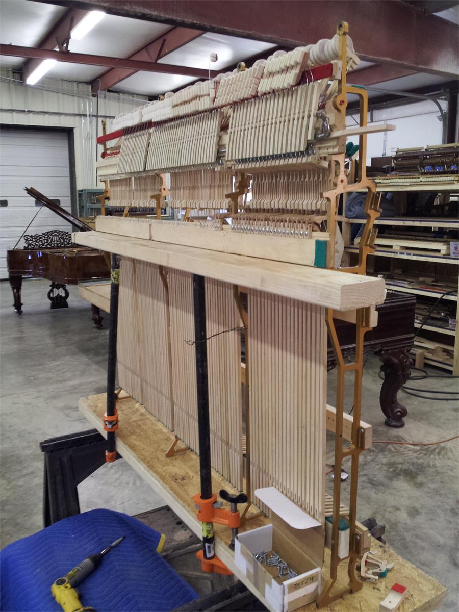

    I work on a MH upright, newish, that has an annoying after-ring that clearly emanates from the monochords only.  I'm looking for solutions that folks have found to this issue by installing damper extensions.  There's plenty of force on the strings applied by the damper springs, in fact, more than is desirable in terms of touch characteristics, so it's not that and I'd prefer not to increase that force even if it were to have the desired effect.
    It may be that the dampers are touching or are near a harmonic node but there aren't any realistic options to moving the dampers.  So the only options seem to be extending the existing dampers by installing longer dampers or adding a damper wire extension (see below).  What have any of you found to be the most effective and if it's the wire extenders where did you get those parts and how did you go about attaching them.  I'm thinking this type of idea though for the monochords (the picture below is for the low tenor),
