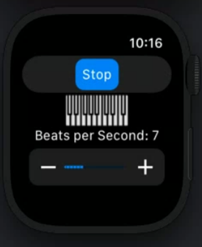

    I'm a new piano technician apprenticing under an RPT here in Denver. I've been working on different temperaments, still haven't tuned a decent one yet, but practicing!
    I've been trying out the Jack's stack / Cerisano 'Skeleton' from last month's Journal and always find myself asking if my F-A is 7(ish) bps. I've learned some of the things like "From Chicago to New York" - but wondered if I could make more of a visual-tuning aid tool (ETD/strobe tuner-esque?) - so I whipped up a quick app that does just that. Set a beat speed, press start, does the partial beat in time with the watch?
    If anyone wants to try or provide feedback just let me know. I am now currently trying to get the apple watch to play back specific reference tones with little luck, but we'll see.... I'm also happy to move this over to Android watch as well, I just didn't have a watch to test with...
    It's free! - ‎PianoBPS
    I'd never plan to make money on the app store, but if you like it/use it, consider buying me a coffee instead!

    This looks like it could be helpful.
    Lots of us have iPhones.  Not so many of us have apple watches.  Have considered producing a version for the iPhone?

  • 3.  RE: New piano technician, made an Apple Watch beat speeds app
    Posted 05-31-2023 14:47
    What a brilliant idea! A really helpful app. If it could be an app for iPhone or Android phones rather than watches it would be really great.
    I tune exclusively unequal temperaments and do so using an ETD to specific settings. An app counting beats would enable aural tuners to be able to replicate my results aurally which would be fantastic.

    There are some really great responses here and I am always fascinated by how much knowledge you all have!
    Porting this to an iPhone/iOS build would be very simple and would be happy to release it if there's interest - it's simply an image flashing so many times within a second...
    Here's a quick video of how it works (I know nothing about editing so it's kindof weird, but by the end you get the idea): https://youtu.be/-llH-o0_uR0
    The goal isn't necessarily COUNTING beats - the goal is to give yourself a target. Particularly on that first pass. If I can get 90% of my temperament in a 10-15 minute first pass, I can refine with checks. I find the flashing on my wrist to give my brain a baseline speed to shoot for.
    It's worth noting that I don't really expect a tuner to use this tool for long. Hopefully in the next few months these things will be cemented in my brain - but any help to get there is welcome!
