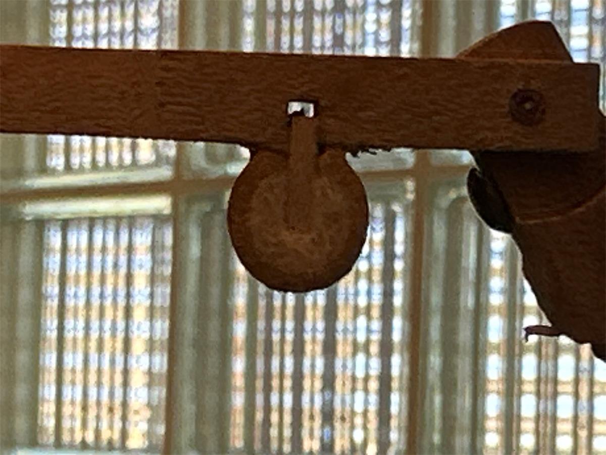

    Not only are these knuckles hard, they are far from being seated.
    Vintage S&S D w/ rebuilt action very hard knuckles not seated properly

    Definitely would improve with a knuckle replacement job :-)  Possibly that's a source of the noise as well.
