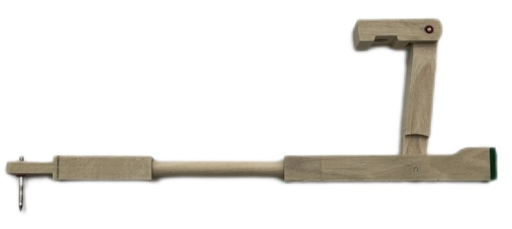

    I need a few whippens with the long stickers like in the picture, By chance what brand is the piano ? i need them for a Kingsbury made by thr Cable Company

  • 5.  RE: Piano Key Repair
    Posted 09-06-2025 18:39
    Do you need the wippens or the stickers? They are two different things.
    Look in the Schaff catalogue for a wippen similar to what you need.
    They also sell adjustable stickers.
