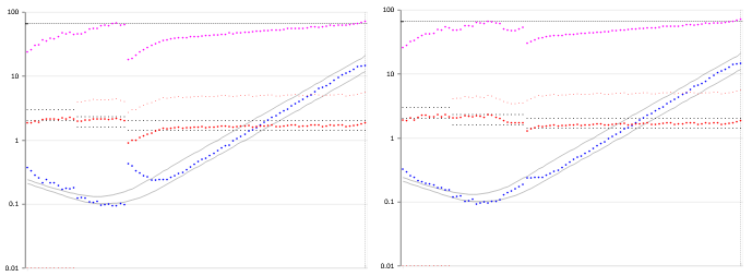

    Timothy sent me the file, and I was able to analyze it. As far as I can tell, the excessive bass stretch comes from a combination of two factors: the very poor scaling and string quality of this particular instrument, and the way pianoscope models inharmonicity in the default setting. Since this might affect other users as well, I've just posted a short article about it in the pianoscope forum.

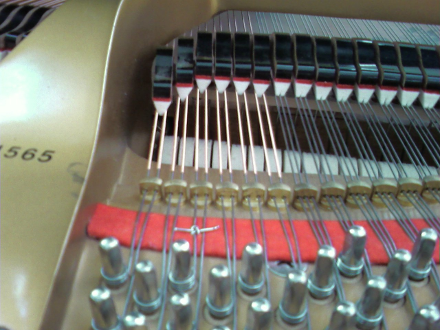

    Hi Timothy (and others who have struggled tuning these little Yamahas)
    Yes, they are a mess to tune - above that hockey stick curve in the graph not so bad...
    I was able to use strings ordered from J.D. Grandt - he has a rescale from Tremaine Parsons to replace the lowest 6 unisons above the break with wound doubles.(see Frank's article to view the current graph - one of the benefits of using the newer apps that display the graphs)  Completely reversible since just the outer holes in the existing agraffes are used. No changes to hitch pins. Dampers fit perfectly without adjustment. It straightens out the graph for a much better blend and best of all makes the piano tuneable and more stable through the seasons. Reasonably priced and just took a few hours of my time.
