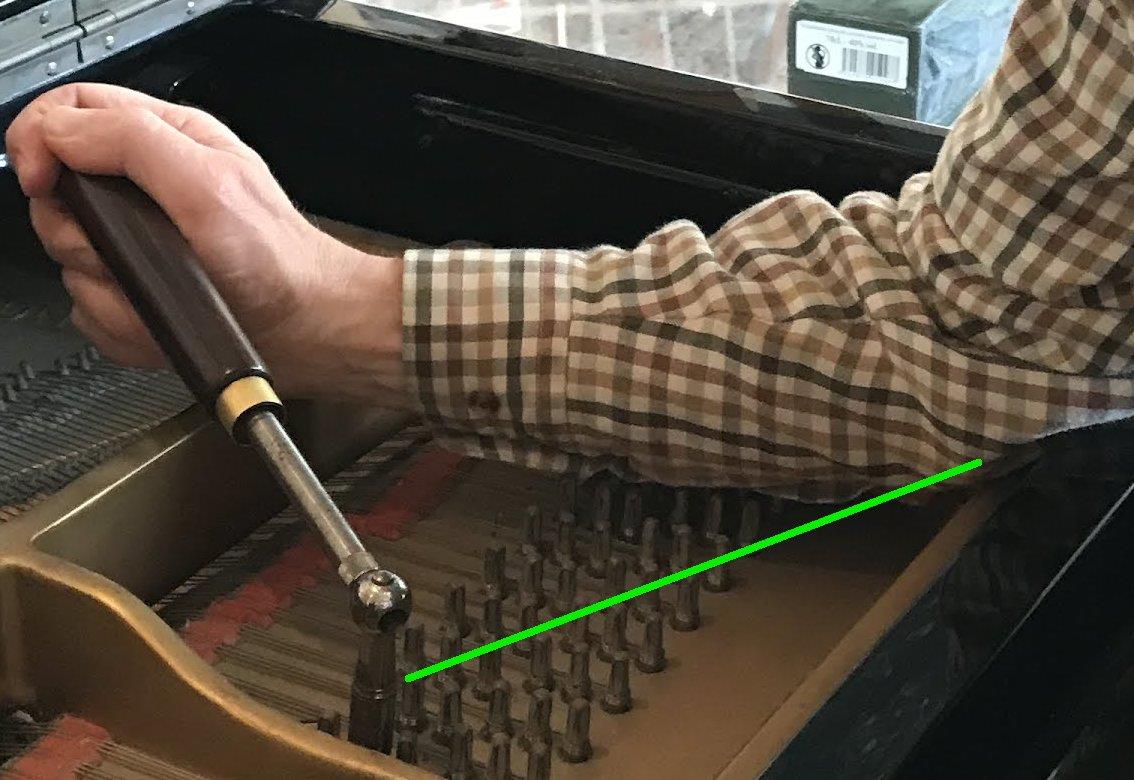

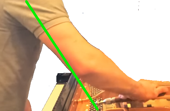

    Recently I took issue with the originator of an instructional video about posture when tuning.
    The instructor was demonstrating tuning and doing so standing up. Instead, generally I advocate sitting down and specifically resting my arm over the front of the frame of the instrument and by doing so limit movement to what is made possible by wrist and fingers.
    If standing up with one's arm not anchored, one's relying on all muscles further back in the chain of hinges that the body represents and balance right down to the feet.
    However much the operator makes a conscious effort not to do so the capacity of the body to produce unwanted downwards forces on the end of the lever is there.
    When learning to play the piano often teachers will address the student's posture from which the hand may best caress the keys. In my opinion attention to muscle control when tuning is equally important.

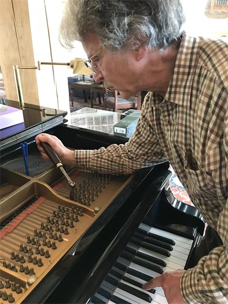

    Today upon visiting a friend for lunch he'd told me that the BBC had come to record him a few weeks ago . . . and it's been months since I dealt with his instrument. I'd brought tools just in case anything needed tidying up and I did a unison that he'd noticed and a couple more. It was up at the top end and rather than sitting as I would normally I found myself standing up . . .  and realised the possible relevance of the innate position I'd adopted.
    With the elbow wedged upon the frame of the instrument, the only possible forces are horizontal
    Here the only possible forces arise from wrist and fingers, there being no other muscles involved.
    Here the wrest pins were stiff so I wasn't worried about leverage from the top of the tuning shank onto the pin but in other positions often I'll hold the handle differently and apply an opposing force at the front of the lever to that at the back so as to enhance the rotational vs lateral force ratio.
    When teaching students who come to me I'm advocating this tight control of the lever and care to adopt posture to achieve it. How many others give importance to this?
