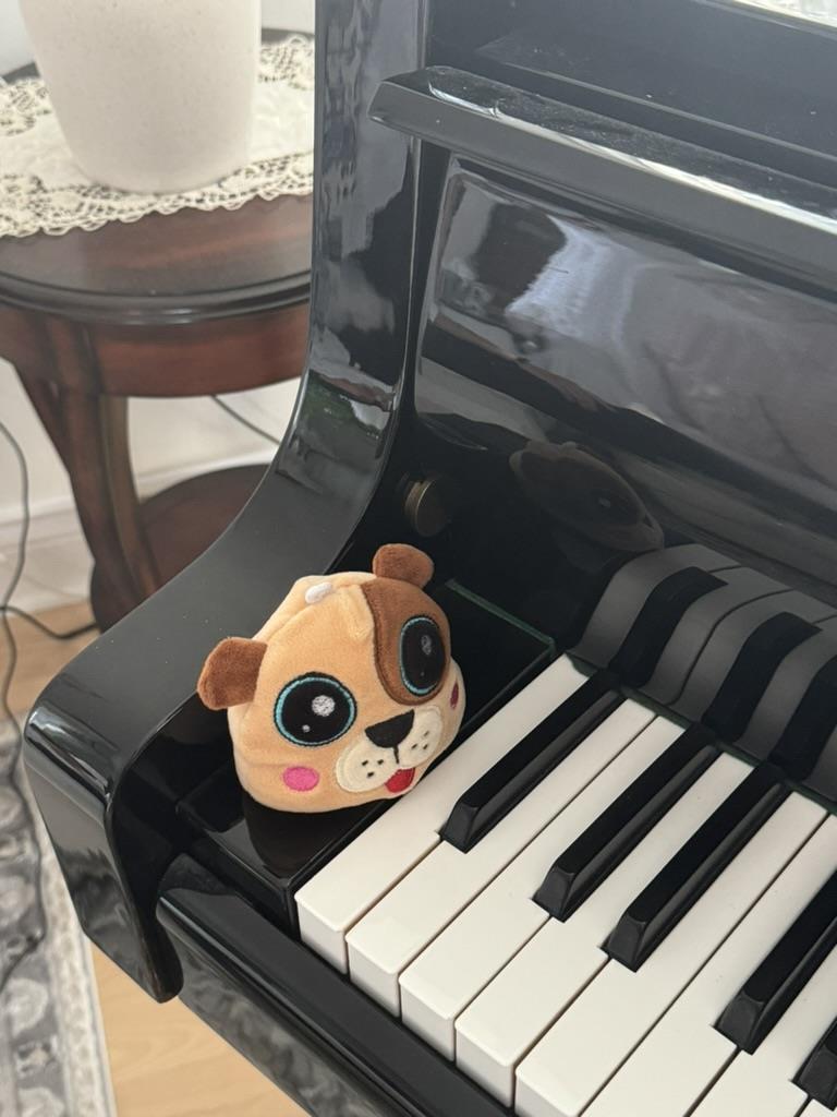

    It's Jurgen Goering who showed us to use a cute beanbag character to protect the student's hands while being usable in all sorts of educational ways.
    I thought it was brilliant !

    Now THAT is genius!!
