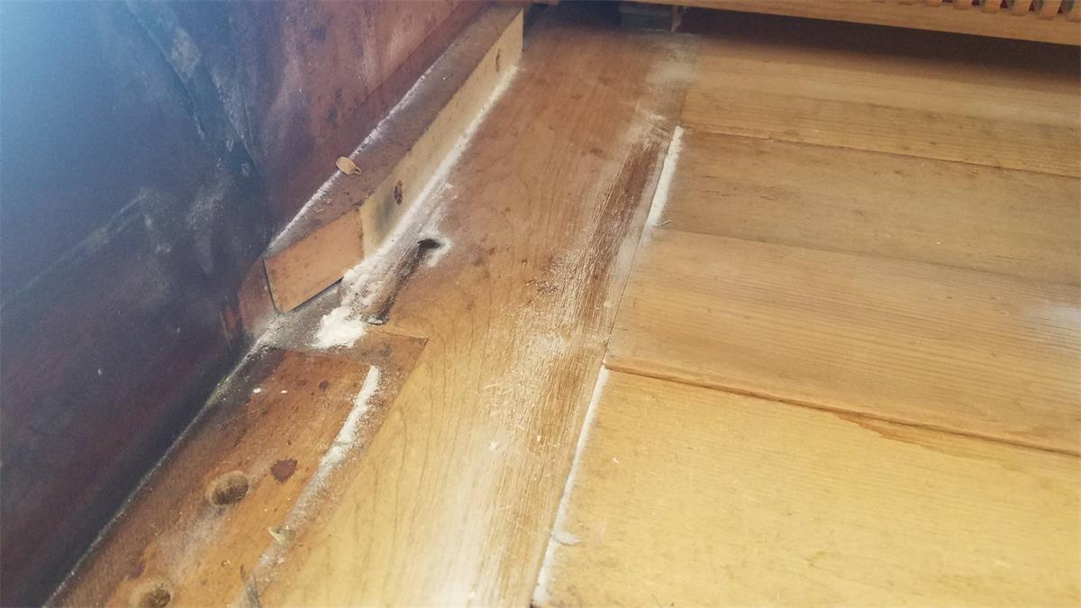

    My personal opinion is that teflon powder has no place in piano technology. Yes, I hear the argument "it must be properly used" but it rarely is.
    teflon accumulation in action cavity.
