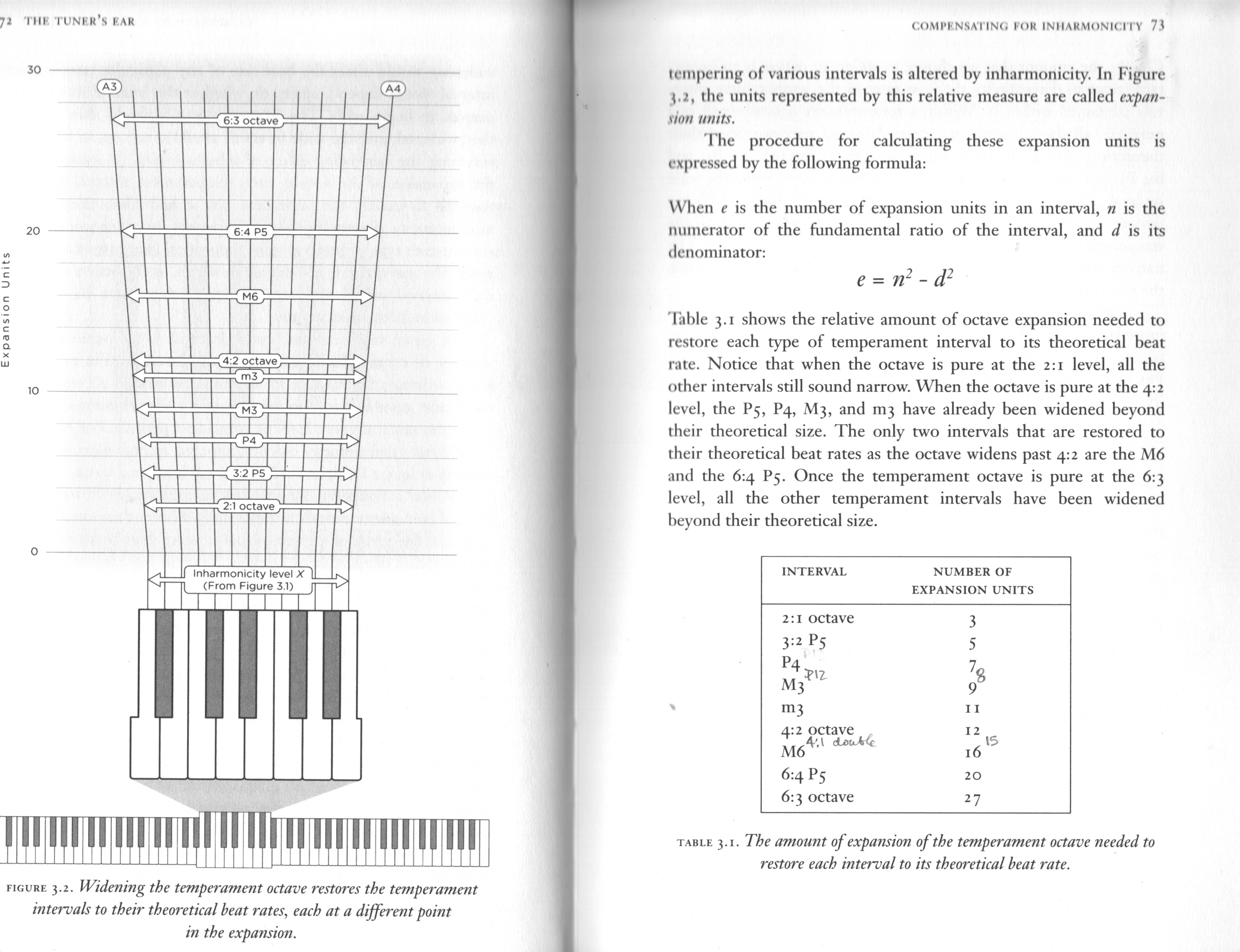

    At regular intervals here, I post my favorite page from Dan Levitan's "Craft of Piano Tuning". (The comparisons are based on an inharmonicity of 1.0.) As can be seen, the 3:1 "octave" is far more immune to the consequences of the prevailing inharmonicity than the 4:2 and 6:3 single octaves. The 2:1 simply has its head in the sand, as far as these consequences.

    Please excuse me but "As can be seen, the 3:1 "octave" is far more immune to the consequences of the prevailing inharmonicity than the 4:2 and 6:3 single octaves. "
    I'm clearly being thick but don't see what is being said here other than tuning to the P12 harmonic being less stretched.
    In the bass on shorter instruments I find that P12 tuning results in the bass not being low enough.
    Very interestingly there is a difference between inharmonicity of strings with mass in the middle of the string - the odd partials are flatter than the even ones and as a result the P12 will give less stretch compared with 4:2 tuning.
  • 21.  RE: Pure Twelfth tuning
    Posted 09-29-2022 21:52
    David Pinnegar wrote:
    "Please excuse me but 'As can be seen, the 3:1 "octave" is far more immune to the consequences of the prevailing inharmonicity than the 4:2 and 6:3 single octaves.' "
    Don't worry, David. You're not being thick-headed; I'm being obtuse.
    Let me rephrase that:
    The 3:1 octave messes up the overall tuning less than any of the single octaves. The 2:1 drags everything above it flat, an the 4:2 pushes everything below it (the 2:1 and the 3:1) sharp. As does the 4:2, by a bigger amount.
    This is all based on Dan Levitan's "interval inharmonicity" (the inharmonicity created by combining the individual inharmonicities of the interval's two pitches).
    Many people in this thread have said that the 3:1 is the best compromise among the octaves for carrying out the temperament to each end of the piano. I agree.
    You wrote:
    "In the bass on shorter instruments I find that P12 tuning results in the bass not being low enough."
    That's why I run my 6:3 all the way down to the bottom. Violinists need plenty of expansion in those lower octaves so that overtones from them agree with their intonation above the treble staff. I once (for shorts and gaggles) tuned the single string at the bottom with an 10: 5. I heard about it after rehearsal. The one piano piece on the program was the Ravel P3, and low octaves of the slow movement sounded like indigestion.

    Bill wrote, "But (a minor correction), the top half of that octave bisected by C4 is actually a 4th."

    Bill wrote, "<snip> But for most pianos, the 6:3's narrowing of the 2:1 below it and widening of the 4:2 (and other single octaves audible above that) is not objectionable ("noisy" as Peter would say)."
    I'm not understanding. Are you saying that you are using a 6:3 octave and allowing the octave below to be more narrow by default? Meaning you are not moving the lowest note of the lower octave to add comparable stretch? Would you not have to stretch downward as you would upward, if not more so?
    Bill wrote, "So, for my own work, moving from a 6:3 to a 3:1 as the basis for the temperament would actually make my 5ths  busier. <snip>"
    I definitely don't understand this one. I will have to ponder it. If I am being a bother, no worries. I don't want to waste your time if I haven't done my homework. I do appreciate you responding to me, and I love your "<snip>" idea. ;-)
    It'll make more sense to you if I correct my error. Referring to Levitan's chart of expansion units, if the single octave is tuned 6:3 (expansion unit of 27), that width results in a widened (NOT NARROWED) 2:1. The same correction applies to the coincidental partials above the 6:3 (say, the 8:4, with an expansion unit of 48): they'll be pulled flat by being to the 6:3's lower expansion unit, not widened sharp. My bad
    This is a natural consequence of selecting one coincidental partial over the others, for tuning.
    I'd be narrowing the "octave relationship" to use for the temperament octave from one of 27 expansion units (the 6:3) to one of 8 (the 3:1 "octave"). Pick a narrower octave relationship and your narrow intervals speed up; same-same, going from the 3:1 to the 2:1.
    Don't lose any sleep over it. <G>
