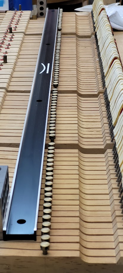

           In addition to fine details already mentioned
          As a starting point, placing a straight edge across the back (near but not on capstans) with the fronts held down can prove uniform key lift and help expose key level and or dip variations.

    Thanks for your comments. I recently moved the capstan line on a Steinway O in order to raise the action ratio. The original capstan line was not straight, veering off as it went into the treble, similar to what you show in the pictures you posted. I did not realize that the original capstan line may have been installed on a curve on purpose. From note 70 on this piano the string height is 190.6mm and then gradually goes down to 187.2 to note 88, a difference of 3.4mm in string height. When I installed the capstans in their new location, I made the line straight with no curve in it. In order to compensate with the lowering string height in the treble, I will do a custom bore on each hammer, so I retain the proper blow distance while having the same action ratio across all keys.
    I do have a 1949 Steinway L that I am going to work on next. This piano as a 6mm variation in the string height. I am not sure how I am going to deal with that problem. And I am not sure that altering the bore distance in the hammers by 6mm is even feasible. Any thoughts?
