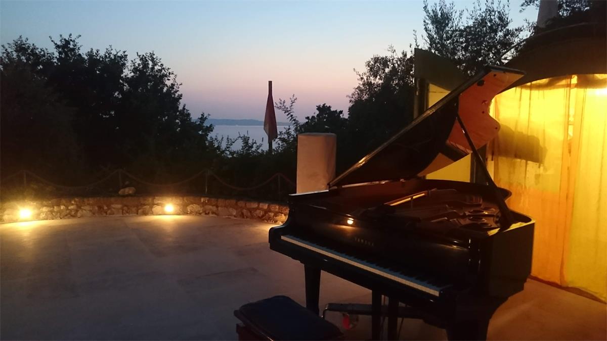

    A 23 year old Yamaha C3 is being used for concerts at an amazing place
    where I'm tuning for a concert next week. The owner wanted me to do some work beyond tuning and the hammers are just a little on the hard side so ideally I'd like to be able to do some voicing.
    However, the instrument is fitted with a self-playing mechanism and removal of the action is clearly not entirely straightforward.
    The instrument is housed in its own self-contained air conditioned room halfway up the mountain for use in an outside amphitheatre but working on it during the day would expose it to high ambient temperatures - so I only saw it in the dusk and really can only do any work at such time. I explained that discretion was the better part of valour and that with this mechanism fitted I shouldn't be doing work on it, let alone under such constraints.
    Hypothetically, how obvious is it to disconnect cables for the removal of the action and what risks or complications does one encounter?
