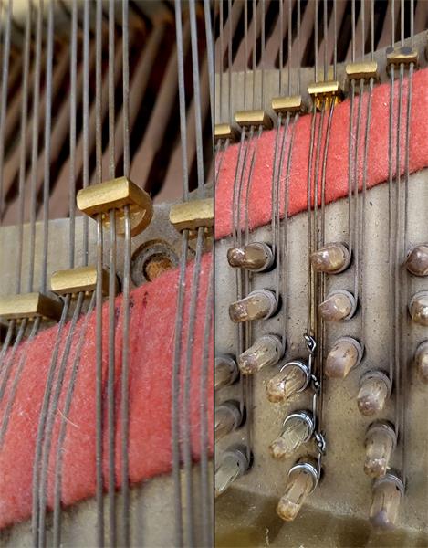

    Last time I had to replace an agraffe I seriously did not want to have to replace the strings. This is what I did, and there have been no problems. Knowing how to do a string splice can save you a lot of time and aggravation.
    saving the strings with an agraffe replacement

    Posted 07-08-2022 12:39
    Splicing is my preferred method as well.
    Ed F.: It took me about 5 readings of your post to figure out WHAT you were talking about. I finally got it though. Not bad, but I'd still splice probably.
  • 19.  RE: replace trichord agraffe and save the strings?
    Posted 07-08-2022 15:15
    I am a little confused about why one would splice a string as part of replacing an agraffe??
    Regard,s
  • 20.  RE: replace trichord agraffe and save the strings?
    Posted 07-08-2022 18:04
    In my case it was 100% because I didn't want to have to replace the strings and cause instability on two adjacent notes. I've tried breaking the becket and straightening the leftover string for a new coil, as Wim suggested, but for me the splice, as I posted, was SO much easier and didn't require any callbacks to touch up those notes.
