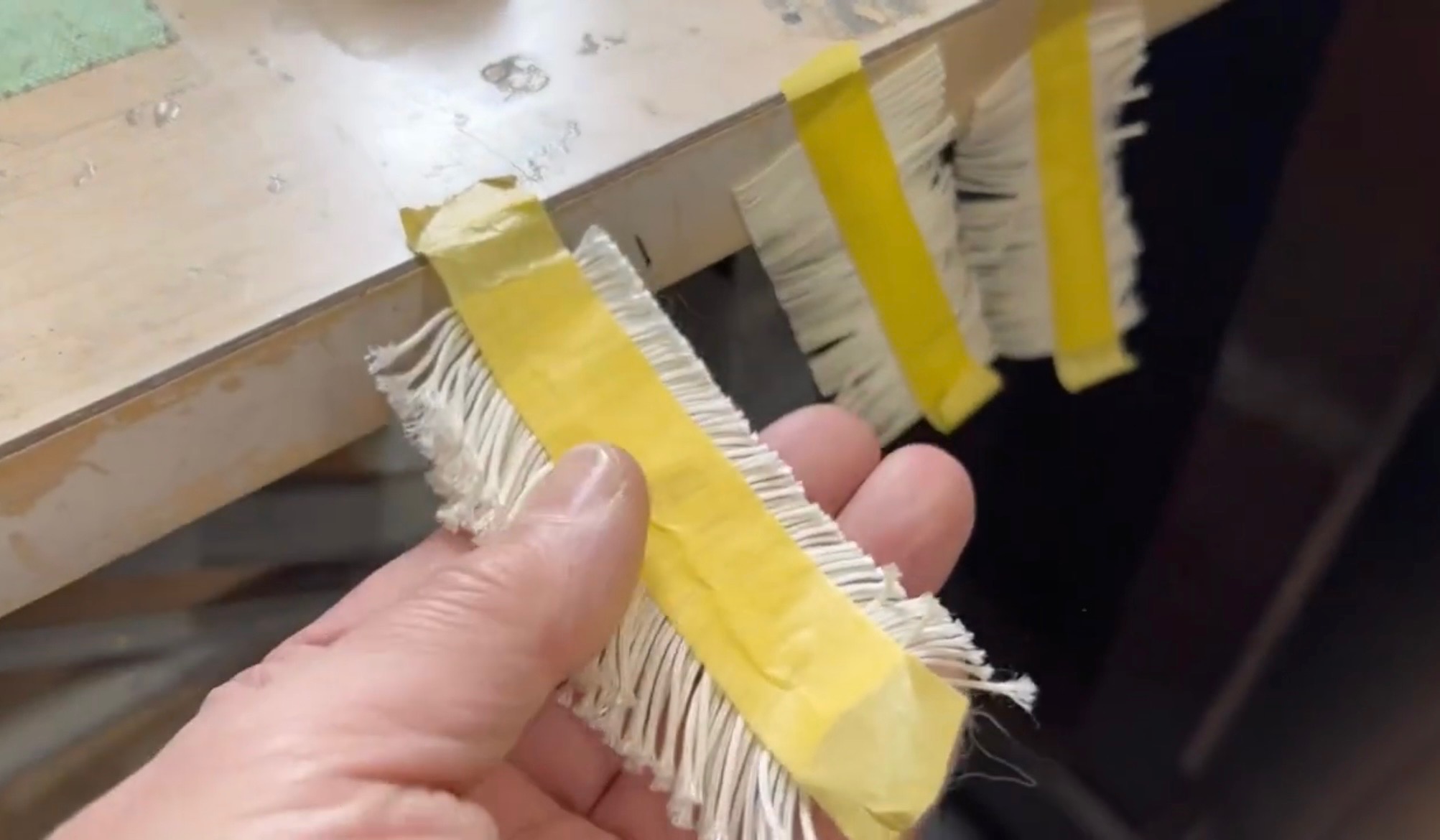

  • 23.  RE: Replacing Yamaha hammer butt flanges
    Posted 03-11-2026 08:37
    Elisha,
    Nice work!
    Do you use the dowel or cardboard method for cutting your strings to length, or do you have another (cooler) method? 😉
  • 24.  RE: Replacing Yamaha hammer butt flanges
    Posted 03-11-2026 12:05
    Hi Peter,
    I've tried all sorts of improvised methods, but I've found that a 1/2" dowel works best. As shown in one of the videos I posted (not my works), using masking tape helps avoid messy cord management. Wrap the cord about 90 turns, tape it, and then cut.
    Screenshot image is from that video.
