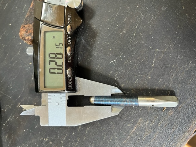

    Here is a picture of a pin. It's a Nippon 2/0  .281inches
    maybe it's not original. All the pins are the same.

    If I use 2/0 pins then I should replace the plate bushings?
    Anybody know the size those are?

    Pin size. If they were tight coming out, use the same size. At most, since the strings were rusty, I would clean out the pin holes with a wire brush. What I've used in the past is a 22. caliber rifle bore brush. You will need 3 or 4 for the whole pin block.
    The width of plate bushings are all the same. There are different lengths. Look in the Schaff catalogue for the same size that came out of the piano.
