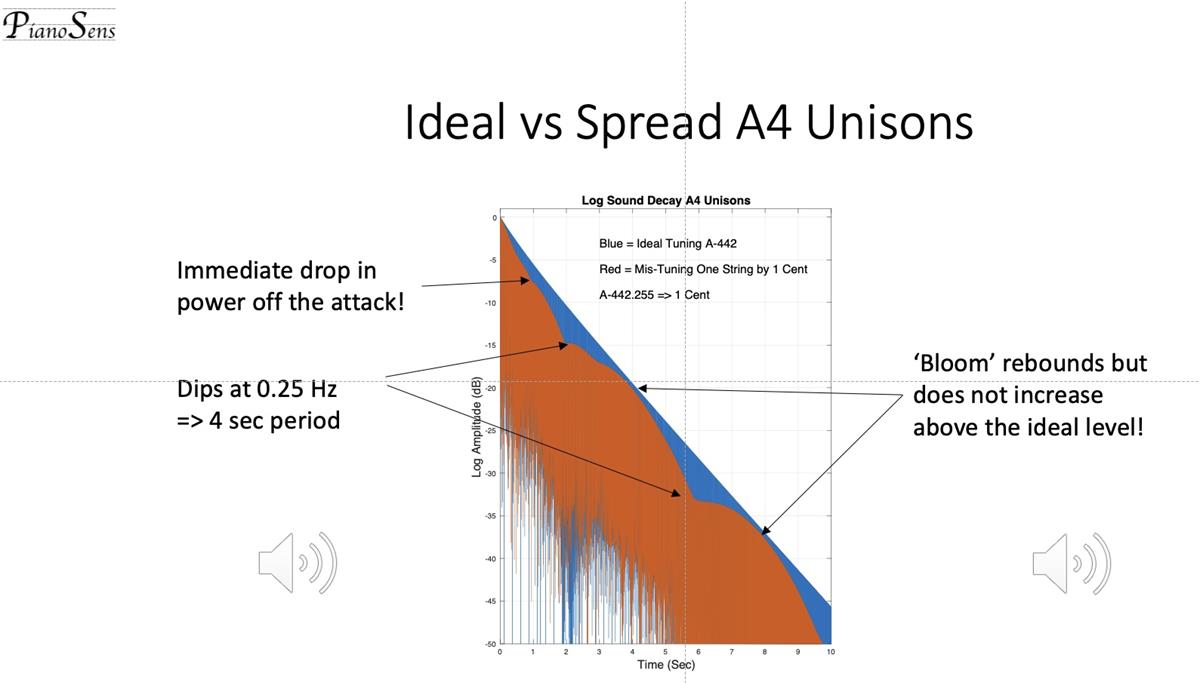

    Geoff, I also agree with your feeling that 0.25¢ accuracy numbers are "way beyond real world expectations," if I understand you correctly. For example, I estimate that near A440, where there is roughly 25 Hz to the semi-tone, working with a test of major third (M3) progressions (during an aural tuning), the best that I can "give" myself is a one beat-per-second coincident partial resolution in the progression test. With the M3 being 5:4 that leads to about 0.25 Hz or approximately 1¢ accuracy for one of the notes of a two-note M3 interval. On a good day! Regards, Norman.
  • 11.  RE: Sensor Position Invariance. YouTube Video
    Posted 01-21-2024 12:18
    Dear Norman and Geoff,
    This is the picture of what Norman has described. It was done months ago in preparation of my course which I have given to many PTG groups. It is a picture of an A4 where one of the three usisons is mistuned by one cent, or 0.255 Hz. It shows exactly what is happening as the power is immediately sucked out in the first 1/2 second, and the 180-deg crossings of the harmonics are kicking in followed by the first 1/2 cycle 180-deg crossing of the fundamental in 2 secs, and the rebound 2 secs later, the so-called 'bloom' which is not really a bloom but a re-phasing of the next 1/2 cycle where the phases realign.
    It is VERY audible when compared to the ideally tuned unisons. I play these audio files for the class. Everyone, 100% of the tuners, agree in the class. I am happy to offer my class to both of you on a zoom session.
    Respectfully yours,
    Steve
    A4 Ideal vs Mistuned by 1 cent 0.255 Hz

    Steven, thank you for the kind offer of a Zoom session of your class. Appreciated, but I'll hold off for now.
    BTW, in my post I was targeting the tuning of the piano, not tuning unisons. And as I read Geoff and Nathan's posts, I think they were doing the same.
    Good point on tuning unisons, and the risks with inaccuracies. I don't recall having heard the effect that you describe in my tuned unisons. The implication in what you describe, though, might be that my (and other's) accuracy in tuning unisons already is of greater accuracy (than with tuning most other non 1:1 intervals) -- considering all the coincident partials available to listen to when tuning a unison!
    Regards, Norman

    Norman and Peter,
    A couple of things:
    As stated earlier, the loss of power on the attack comes from the 180-deg phase cancellations starting with the upper partials and finally with the fundamental. You can only compare the loss of attack power by doing an A-B back-to-back comparison. I play these for the classes and people are shocked at the difference. If you just are tuning without the comparison, you would not necessarily know. I share a story with you. I have demonstrated this for more than one top tuner, concert level I might say. You need to be on a top-quality concert grand piano where everything is all lined up, and yes, it is very noticeable. The concert tuner got to 0.4 cents on the unisons, as I measured it afterwards. Then I dialed it to 0.1 and he exclaimed the he had never heard that kind of sound before!
    Look, I am just saying that the time has come for us to have a reference level way of tuning without variances, repeatable, reliable, not subjective. Why not?
    The other thing I keep posting on is the ETD's inability to resolve acoustic smearing in the frequency analysis. Acoustic interference is most exemplified with false beats that are only a few Hz apart. The sensor cannot 'hear' the acoustic interference. It does, however, 'see' the mechanical false beats of 'vertical minus horizontal' frequencies that are partly due to poor bridge pinning or bad wire.
    You also must remember that even with non-unison issues from note to note, if the acoustic variability that cannot get resolved in the ETD produces an error of 1 cent, the standard deviation of accumulations of all these errors across the piano is multiplied statistically by the number of notes on the piano. So let's say your standard deviation error is 0.5 cents from acoustic interference. The square root of 88 is 9.38, so if you have increased the probability of the spread of out-of-tune-ness by at least 5 cents or more. Why do you want to start out with this kind of error, knowing you are statistically increasing it as you go? On top of that, you know the piano will spread due to playing and environmental changes. You start out with unnecessary errors, and now the spread over time is even greater! It makes no logical sense if you have a method that starts out with minimal error!
    I need customers who want to participate in the raising of the bar. That was Paul McCloud's term when he started using this new method.
    Does it make a difference on lesser pianos? Ask Paul, and he will tell you it does, and his customers are telling him their pianos simply sound clearer and cleaner than before.
    Perhaps my device will catch on with a new generation of tuners who want to get pristine tunings from the get-go in their emerging careers. That is probably the path forward.
    My first two customers were young tuners who have not yet passed their tuning exams and are tuning in noisy environments.
    We shall see how long it takes and how much teaching effort it takes to get on a new standard of tuning. I would love to be part of that.

    Paul wrote: <"Can anything but a very sensitive machine tell, or even care for that matter, if a tuning is more than 0.2¢ off?".  Well, unless you have the experience of tuning to this level, you might not know how it sounds.  Once you hear it, when there is no beat at all, consistently, then you have to admit that what you've been doing is not as good as it could be.  We don't wait long enough while tuning unisions, for example, to hear a slow beat.  By ear, it takes too long to hear it, so we just don't take the time to do it.  But if your app can give you that information, then you can make corrections to get within that range +- .2 cents very quickly.  You do hear it. ....>
    Translate simply: If you know what it sounds like, you can tell when you have (or have not) found it."
    A few years ago a Yamaha concert technician was making chapter presentations. His topic was "rising unisons." He demonstrated on a new, top line 7 foot Yamaha grand piano. He said "Listen to this unison. When I have found the right spot, the sound will seem to rise up and float above the piano. When I don't have it right, the tone will drift away downward, below the piano."
    He demonstrated this with several notes, letting each note sound for several seconds, and the technician audience began to smile in amazement. We could hear it!  He said "I don't know what it is, but I know I can hear it when I've got it and I can hear when I haven't got it."
    After that, at least for a while, on very good pianos in very good condition, I was sometimes able to tune some rising and floating unisons.
    I now wonder if what we were doing was just tuning very, very pure unisons, within the .2 cents window.
    (Years ago I learned that violinists get certain effects by imagining that the bow is weightless, just floating in the air where needed. Images like this can sometimes help us to reach higher levels of perception and performance with our "wet" operating systems.)

    Hi Ed, I assume you saw my post on this thread about the 180-deg phase shifting creating the 'bloom' effect. If you want me to describe it better, we can do a little zoom session. Let me know when you what to schedule it. Evenings are good. This evening is out because I will be doing my 'class lecture' at the Orange County PTG. I am really busy doing lots of PTG meeting sessions now. Respectfully yours, Steve

    I could be wrong but I don’t think that Ed was talking about. Bloom, Steve. I attended a class by Yamaha’s Ace Ugai and I also was tutored by him in tuning unisons. He taught me to listen for the sound coming from above the soundboard. It didn’t develop over time. I didn’t have to wait to hear any bloom. That doesn’t negate the efficacy of your approach and I would sign up for your device if I wasn’t at the end of my career and trying to not spend any more money than necessary. I have heard a lot of theoretical discussion about your approach but the bottom line is whether or not it delivers results. Paul McCloud certainly thinks so and, despite all the arguments pro and contra, the only way to decide is to try it.

    Thanks, Bob. Last night I was presenting to the Orange County PTG. At the end of my class slides, I went up to a Bosendorfer 185VC, put my device on C4, one string at a time individually tuning each unison, and about 10 secs per string, nailed each one to 0.0 or 0.1, and unmuted all and played the result, and it was 'perfect'. The stability and consistency and invariance allows this. It is a 'new way' of tuning.

    I remember Ace at a NE Regional Convention in a class with David Durban. This discussion about "floating" unisons and projecting them outside the piano was entirely new to me at that time (and admittedly I was skeptical).
    After class I tried analyzing the unisons Ace had tuned, interval checking each string to see if there was some pattern I could recognize. There was not, AND the strings were NOT tuned at perfect "zero". What's more, Ace was right there next to me and said: "you can't do that" (I'm paraphrasing) "you must listen" and then waved with his hand outside of the piano.
    At the time I was baffled, yet intrigued at the same time. I have since come to settle on a protocol using the middle string as a fine adjustment "controller" of sorts. I know I'm not alone in this.
    Yet, I am still eager to hear unisons tuned as "dead on perfect" as humanly (and machine assisted) as possible.  I will humbly evaluate the pros and cons. Lately I have been incorporating a bit of Tunelab into some of my work. The idea of tuning the outside strings using the machine and then tuning the middle string aurally (David Stanwood mentioned this to me recently on a phone call) seems to be an ETD synthesis of what I've been doing aurally for quite a while. I kind of like it too.

    Indeed, you are not alone in this, Peter. I too attended one of Ace's classes in which he discussed his ideals for unison tuning. Definitely not about absolutely matching the frequencies of the strings of unisons, but about getting a certain loftier sound from the strings combined. It was a great affirmation of what many of us were already doing!
