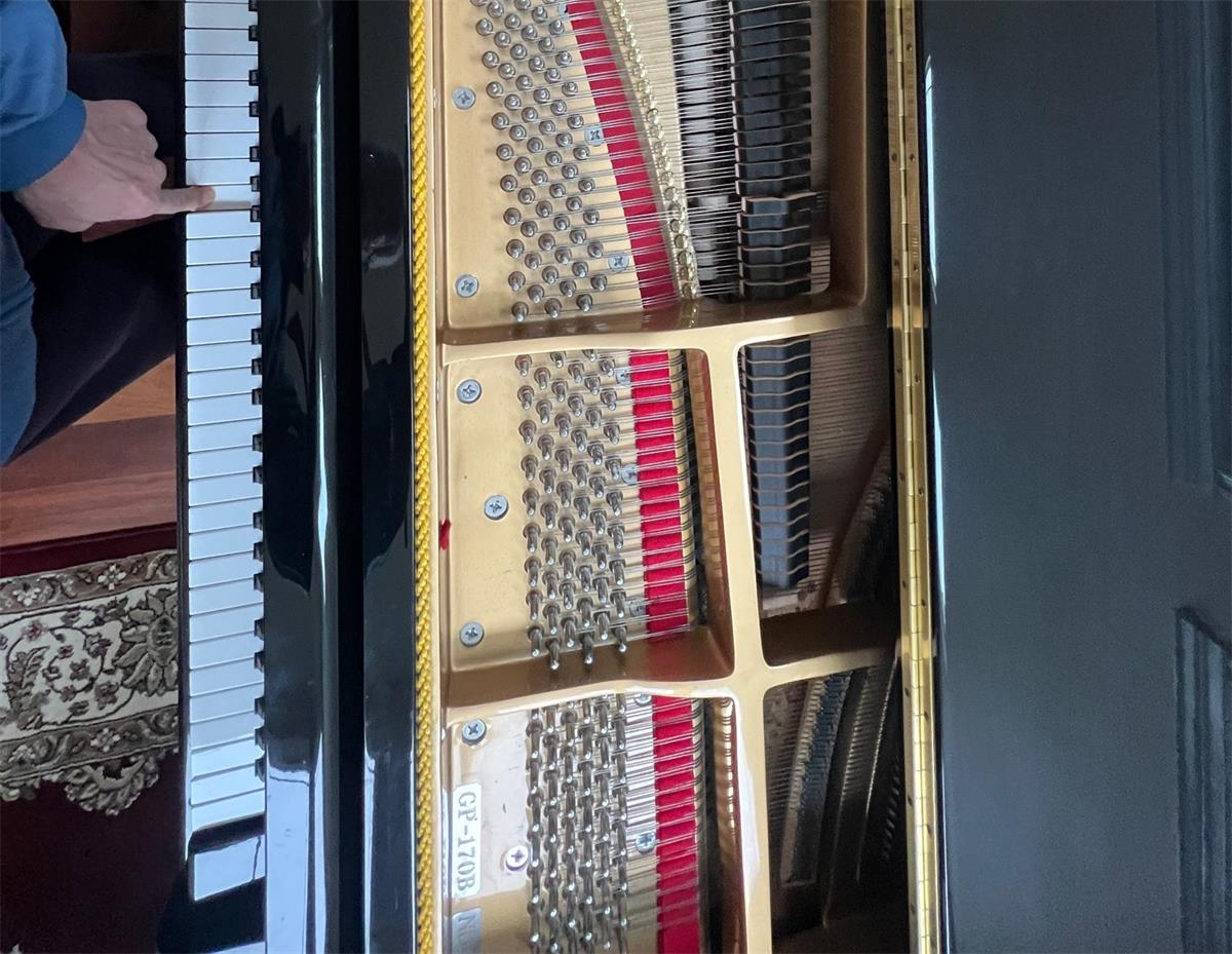

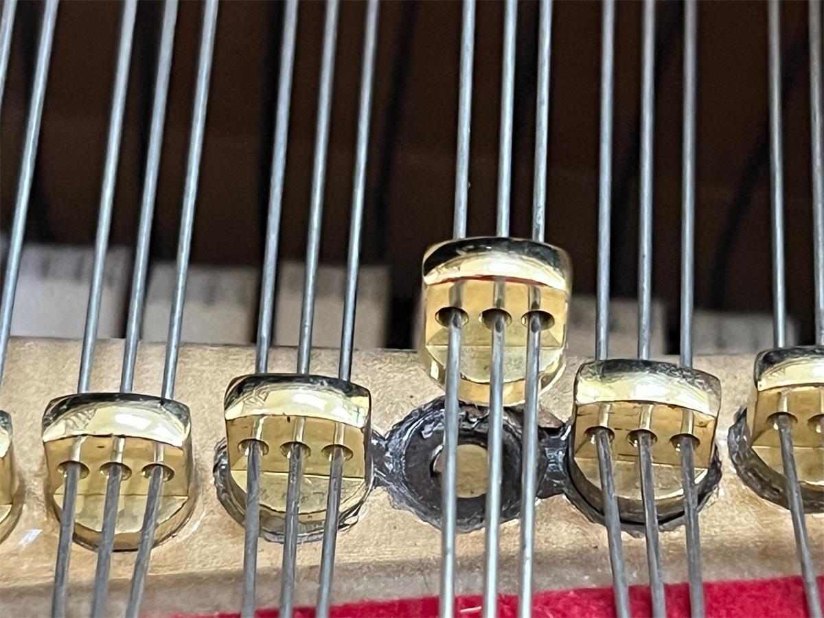

    Greetings! Does anyone have US contact information for pianos made by the Shanghai piano company? I need to find a replacement agraffe for this Strauss GP 170. Or possibly, a suggestion for a supplier who will have this type available.

    Have you removed the stem of the agraff to figure out the size and thread count?  It might be a standard Asian agraff found on most Chinese made instruments.
  • 3.  RE: Shanghai Piano Company/Strauss piano
    Posted 02-13-2023 21:14
    Well it is likely metric thread and if you can't reach the Co you'll have to extract and measure the threads. Good chance that a Yamaha, Kawai, Young Chang or other will fit.
