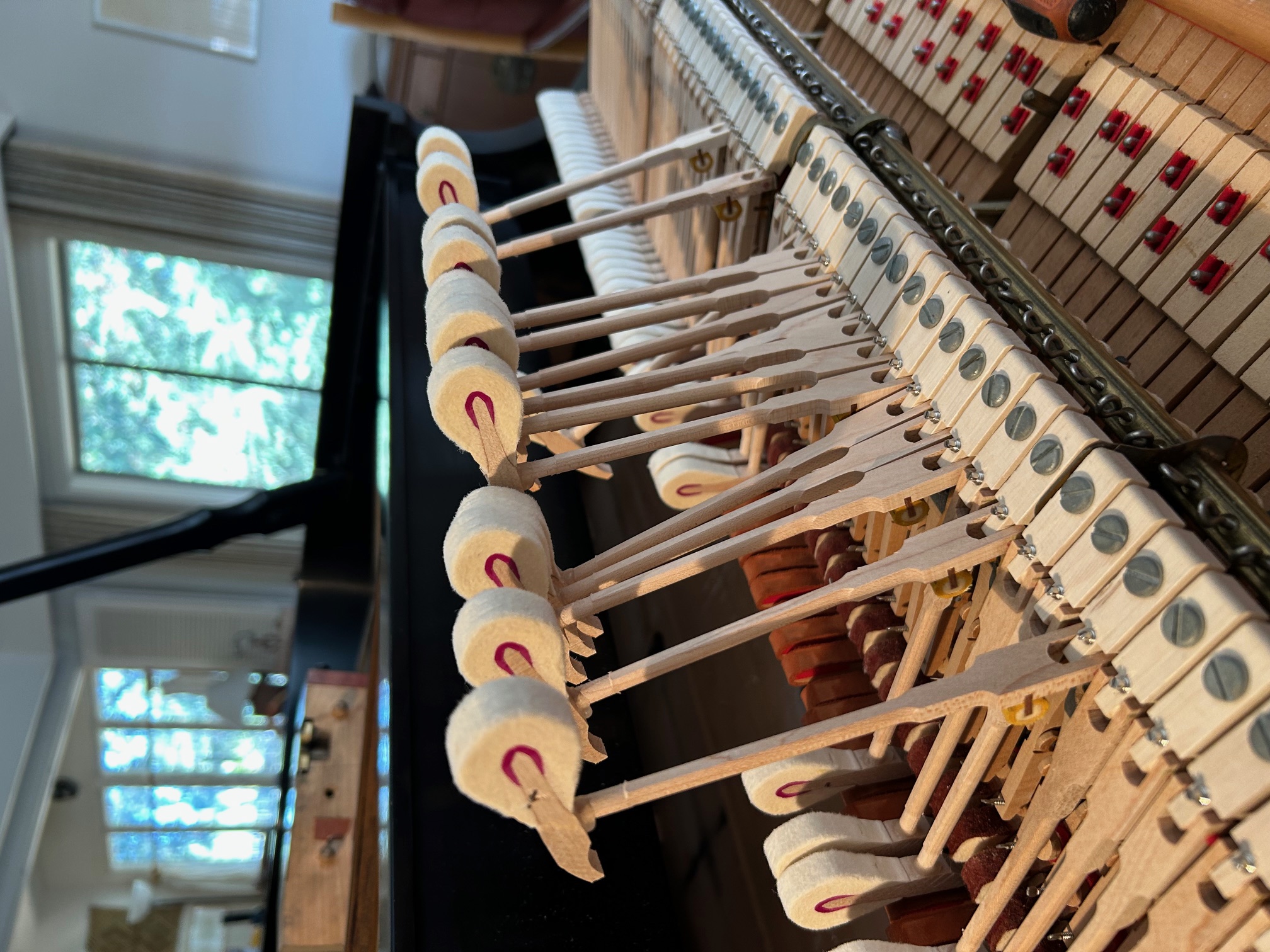

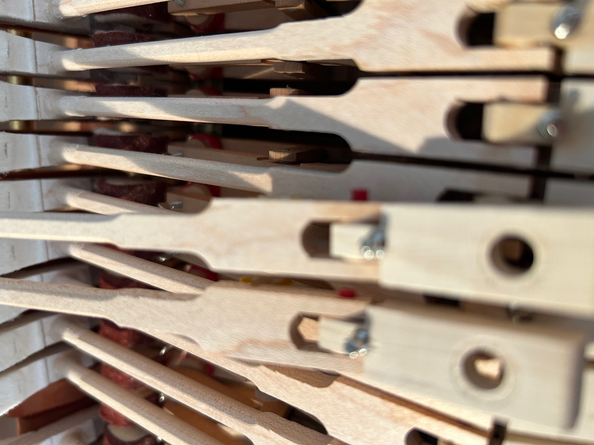

    Is anyone else having these issues with Abel shanks?  Action centers seizing
    and, with that, flange bushing migration (sorry, a little out of focus)
