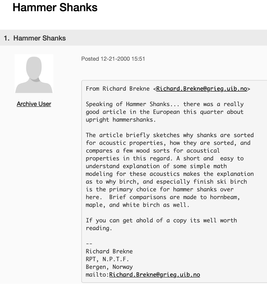

    Meanwhile, I found an interesting post in the Pianotech archives dated December 21, 2000. The link is below, and a screenshot follows.
    https://my.ptg.org/communities/community-home/digestviewer/viewthread?GroupId=1165&MID=420414&CommunityKey=06a50b7b-c49f-4c2a-b32b-ef78b4ed51cc
    At this point, I'm thinking birch dowels for your square piano will be just fine.
    Somewhere in Europe, someone has apparently made a case 23 years ago for justifying the use of birch shanks in the U.K. versus maple shanks. The search engine for Europiano magazine (which I think is the source of the article Richard Broken referred to in his post) is not an effective search engine, so I could not find the article. My thought is that a few birch hammer shanks on your centenarian project will be just fine.
    FWIW,

    Out of curiosity, how would you have responded to Robert Brekne in 2000? Birch shanks seem to have been preferred in his part of the world.
    Has anyone on this thread experimented with birch shanks? I didn't think about the difference in grain count. I think I'll order some and do some testing.

    Reading between the lines of Ric's post, I'd suggest that "Finnish ski birch" may be a particularly high grade of birch that is used for making quality Scandinavian skis. I doubt the birch dowels readily available here have the same qualities. That said, I look forward to your test results!
  • 17.  RE: Square Grand Shanks
    Posted 08-22-2023 17:55
    It was Richard and now he goes by Rigs Brekne
  • 18.  RE: Square Grand Shanks
    Posted 08-23-2023 13:56
    Just found the article in Europiano that Richard Brekne referred to at the time and added a scan of it. Hopefully it is readable

    Unfortunately, the article neither gives taxonomic names for the birch it's refering to, nor the Modulus of Elasticity of the birch mentioned. Only that it is white birch (I believe Betula pubescensgrown in Finland, making it much stronger. Normally European White Birch is not much better than cedar, but it seems to be much harder grown in Finland. I can find no data as to it's MoE or any other measure of hardness.
    Until that can be tested or found, I think I may have to resort to making my down dowels from larger Hard Maple dowels or upright shanks.
