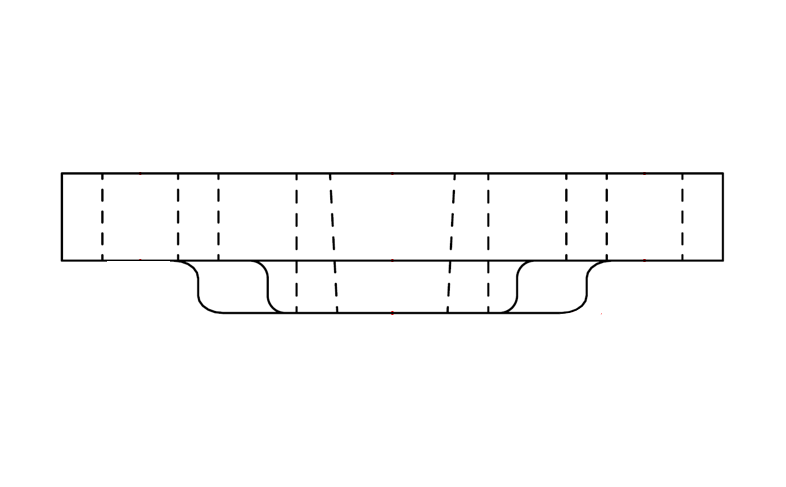

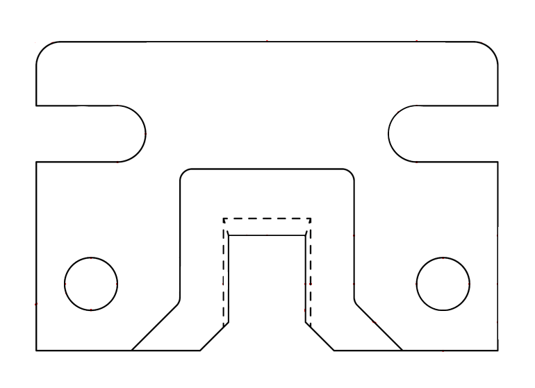

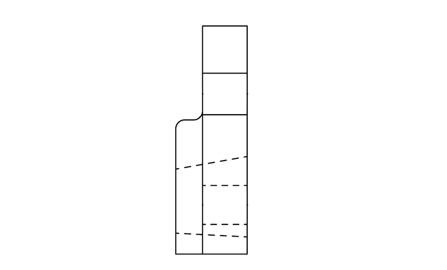

    Attached are some engineering drawings of the plate to get an idea of the design as I've described.
    A drawing of the phosphor bronze keyblock plate as viewed from the front
    A drawing of a side-profile view of the keyblock plate showing the inner profile of the bearing surface on the keyframe pin
    A drawing of a top-down view of the keyblock plate showing the bearing surfaces of the sides of the keyblock plate
