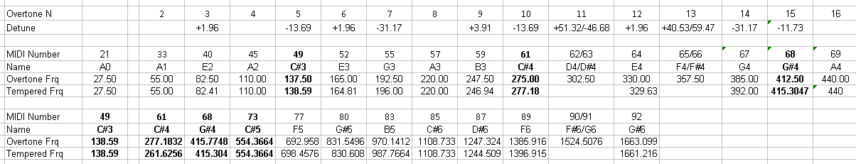

    I silently press a piano key A0 (note 21 in MIDI). Its harmonics in musical notes are 33, 40, 45, 49, 52, 55, 57, 59, 61, 62/63, 64, etc (I'm not taking in the consideration a detune of some overtones).
    Then I hit and release right away the key C#3 (note 49). Its harmonics are: 61, 68, 73, 77, 80, 83, 85, 87, 89, 90/91, 92. Plus, of course, the main tone – 49.
    Here is a table for a better visualization:
    Comparing numbers in the table I see that theoretically the open A0 must resonate with (marked in bold): 5th harmonic (not 49), 10th harmonic (note 61), 15th harmonic (note 68) and 20th harmonic (note 73), the most upper. The energy of even higher harmonic is weak, and they can be discarded, I suppose.

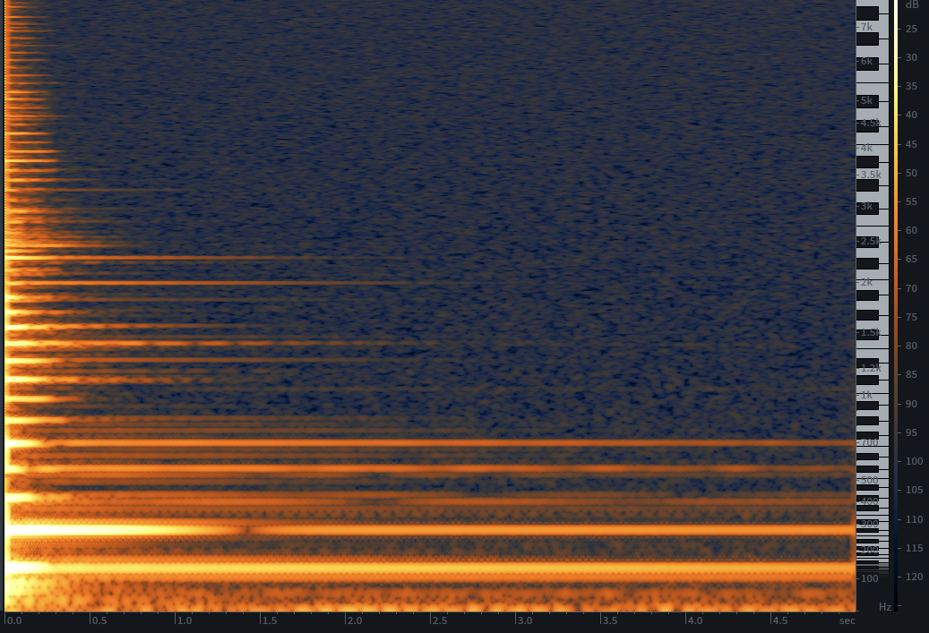

    However on a real grand-piano I hear and see (in iZotope RX) the following:
    1) Obviously note 45 (A2, 110Hz) does sound also, despite that according to the theory it can't be excited by the higher note 49. Then why there's note 45!? And if the one was supposedly excited by hammer of key 49 just mechanically via piano frame and body, then why there are no harmonics with notes 33 and 40? And no main tone 21?
    2) Checking the spectrum I see, as expected, the strong and bright harmonics with notes 49 and 61. But the same time there is the whole bunch of harmonics like 52, 55, 57, 59, 61, etc. Almost all belonging to key (string) A0 all the way up to 25th harmonic. Check the 700Hz boldly shining in the spectrum (note 77, F5). What excited these harmonics like 52, 55, 57, 59? Because the vibration of the string for key 49 had no frequencies corresponding to them?
    Also, why the harmonics higher than 10th, ok, higher than 15th are so prominent in the graph? As I understand the amplitude of harmonic is proportional to 1/N, where N is harmonic number in sequence. So all those upper harmonics like 20-25th must be really weak to be heard or tracked in the spectrum. But they are obviously present in my experiment.

    When you strike C#3, the hammer blow is an impulse which could be considered a bandwidth-limited step function.  This impulse contains all frequencies -- rolling off in amplitude thru the top of the keyboard.  Only after the impulse traverses the length of the C#3 string many times does the string and its terminations "sort out" the resonant pitch and partials associated with the note.  It is the broadband impulse (noise, if you will) of the C#3 hammer strike which is exciting the many partials you observe of A0.
    Try this experiment:  With A0 damped, strike C#3, then quickly depress A0 after perhaps one-quarter of a second, and *immediately* release C#3.  You should hear A0 sounding only the partials you predicted in your analysis.

    Wouldn't this table help to "translate" MIDI notes to Hz?
    I marked in bold the corresponding tonal harmonics of A0 and C#4. Those not marked in bold for A0 are excited too when I hit C#4, but I call them noise harmonics. Let me know what else I could clarify. Thanks!

    Yes, it's exactly what I'm doing. These are frequencies of 25 overtones existing at A0 string:
    (27.50), 55.00, 82.50, 110.00, 137.50, 165.00, 192.50, 220.00, 247.50, 275.00, 302.50, 330.00, 357.50, 385.00, 412.50, 440.00, 467.50, 495.00, 522.50, 550.00, 577.50, 605.00, 632.50, 660.00, 687.50
    These are frequencies of 12 overtones existing at C#4 string:
    (138.59), 277.18, 415.78, 554.37, 692.96, 831.55, 970.14, 1108.73, 1247.32, 1385.92, 1524.51, 1663.10
    I marked in bold those frequencies which are close to each other.
    And supposedly they all must look very prominent (bright) at the spectrum graph (captured when I silently hold A0, then hit and release C#4). However I see that some harmonics are weaker and not so shining. For example, on the pic below 412.5Hz is weaker and seems equal to the non-sympathetic (intrinsic) harmonics 385 & 440Hz of A0 string.
    And the same time non-sympathetic (intrinsic) harmonics of A0, which must be weaker than sympathetic ones, are present at the graph as continuous pitches (as if they resonate too). Check out below the frequencies 385, 440, 522 and a clashing pair of 330 & 357.5Hz. Meanwhile other non-sympathetic (intrinsic) harmonics decay much faster and don't drone at all.
    So I'm curious what defines the amplitude (energy) distribution of: 1) coinciding frequencies (sympathetic harmonics); 2) non-sympathetic harmonics.
